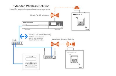

Figure 3: Extended Wireless Solution
Figure 4: Multiple Floor Wireless Solution
Figure 3 represents an extended wireless solution using a wireless hub to extend the reach of the signal to serve a far away remote client at greater distance from the MCX-2000 server.
Figure 4 expands upon Figure 3 with all three remote clients being at greater distances from the MCX-2000 server, perhaps on different floors as the diagram illustrates.
