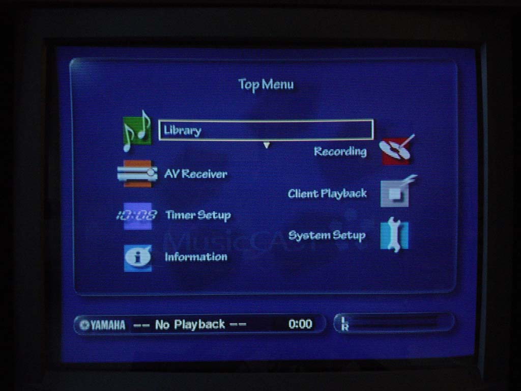

Setting up the system was fairly straightforward. I connected the digital optical outputs and the s-video output to my Yamaha RX-V3000. I then connected the MCX-1000 to my home network via the ethernet port and turned on the server. I was greeted with the Welcome to MusicCAST text display on the unit's front panel, echoed by the MusicCAST startup screen. The Top Menu follows, which allows you access to the following screens and menus:
  • Library
  • Recording
  • AV Receiver
  • Client Playback
  • Timer Setup
  • System Setup
  • Information
System Setup Menu (sub-menus Italicized)
Beginning my setup, I navigated to the System Setup page where I was able to setup my MusicCAST Server and MCX-A10 client. Knowing that I had a DHCP server installed in my home, I realized that I would have to configure the MCX-1000 to receive its IP address from the existing server (you can only have one DHCP server on any network. Having decided to attempt setup without first consulting the owner's manual (just to see if it could be done), I began on the Network sub-menu where I located and clicked on Expert Settings. Here I was able to "Automatically obtain IP address with DHCP" under the IP Address sub-menu. This allowed the MCX-1000 server to obtain an IP address from my existing DHCP server. For those without an existing home network, the MusicCAST server is capable of acting as a DHCP server for its connection to the client modules (in fact this is the default configuration). Having the DHCP option was critical and showed Yamaha's foresight in writing the OS code.

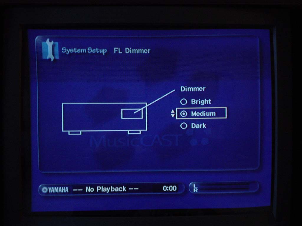

Standby Mode enables you to specify whether activating a client will turn on the MCX-1000 unit or whether the server can only be activated via the Standby/ON function of the remote or front panel. You can set the FL Dimmer (front panel display) to be either "Dark", "Medium" or "Bright". I set mine to "Dark" but would like to see another option: "OFF" as I really didn't use the front panel display during operation. The MCX-1000 may be classified as a consumer audio device, but to me it functions more like a limited PC audio server.
