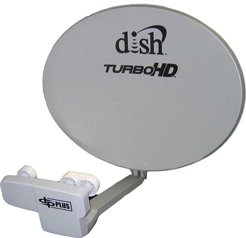

1000-4-dish-turbo-HD.jpgSo with much anticipation I received the latest DISH technology, including their newest 1000.4 dish which had only been out in our area for a couple of months. It is a single dish solution capable of receiving signals from 61.5, 72.7, and 77 degrees West and is suitable for any Eastern US application. In the past I would have had needed to use two dishes to get the signals I am receiving from this single dish solution. Hooray for progress. This dish has three receiver output ports which support direct connection to either three single-tuner receivers or three dual tuner DISH Pro Plus receivers. We went with a dual tuner ViP 722 DVR since it would give us high definition and dual tuners which we could configure in a way that optimized our needs.
