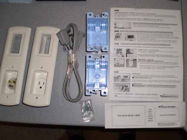

The PowerBridge Total Solution Slim Line kit (long name, we know) comes with two wall plates, and power extension cord (male to female), two plastic "old work" electrical boxes, hardware, template and instructions. The design of the system is simple in principle, you install your cabling behind the wall and the plates finish everything off nicely. What makes this system especially attractive is that it allows you to safely (and legally, per NEC code) run 12/2 or Romex-style wiring behind the wall as well. It does this by providing actual "in" and "out" power terminals that are safely encased within an electrical box where the 12/2 is protected from exposure as you'd expect. It's not only a slick system, it's incredibly easy to install and you can use any length of 12/2 you need, whether you're making a 3 foot run as we were, or running it over or under your house from one side of the room to another.

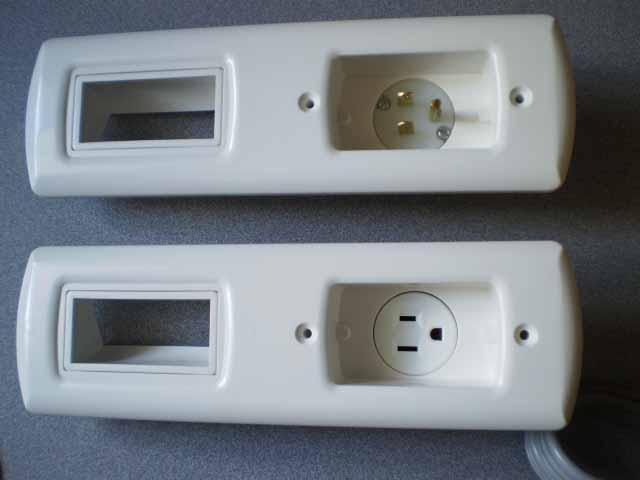

powerbridge-plates2.jpgThe first thing I saw when I opened the box were the two wall-plate systems. My first impression was how smooth and clean it looked, and I how didn’t have to assemble anything on the electrical side of things. I started to visualize how it would look installed on my wall and quickly realized that I could install it horizontally, if needed, to better hide behind the television and work well with my flat panel mount. Turning over the integrated wall plates, I quickly noted that screws held the sockets and pass-thru plates in place. This was wonderful because, if a socket went bad it could easily be replaced with what looked like standard parts (not that we'd expect you'll need to). Next, I noted the heavy-duty power cord, which seemed to be more robust and not just some regular extension cord we all buy to hook up our Christmas lights with. Lastly, I noted the inclusion of the two "old work" electrical boxes which are easily used in existing drywall or even plaster wall construction. These boxes have tabs that open up in place behind the drywall and are fastened in place by tightening the two screws to hold the box in place. Since the outer plate only has two securing points to anchor it to the electrical box, you'll want to make sure to install that box perfectly, since it ultimately holds everything together.
Each plate is tall, and above the power receptacle I noted a square, angled opening for low voltage wiring. When I flipped over the plate I also took note that this angled plastic piece could be removed and replaced with a Decora-style insert that could support keystone jacks. This meant that I could easy affix a plate that would have the component video and RF (cableTV) connections I needed for my room. Since the plate insert gets screwed to the exterior plate from within, there are no exposed screws and the cables will connect securely to the plate itself.

powerbridge-kit.jpgI set about to install the PowerBridge as per the instructions. The only tools I needed to do the complete installation were:
  • Level
  • Pencil
  • cordless drill
  • Razor knife (or drywall saw)
  • Slotted screwdriver
  • Small Philips screwdriver
  • Stud finder (or a good knuckle rap and some ears)
All of the materials were supplied, except for the 12/2 electrical cable. The manufacturer leaves purchase of the electrical cable to the installer, since they have no idea of the length of cable you will need to make the connections behind the boxes in the wall. We'll assume you know how to install electrical boxes, but check with your local building codes if you're unsure of anything - including the cable type & size of wire required for installation.

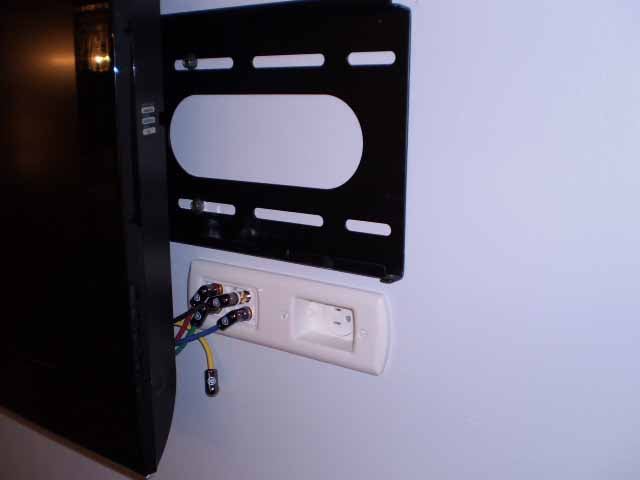

To begin, I located my existing studs with a stud finder and then marked the desired locations for the PowerBridge plates by laying out the template provided. The template should be set vertically for the bottom plate, but can be horizontal behind the television depending on your requirements, location of the studs, etc. I chose a horizontal layout for the top part of my installation as it allowed the finished plate to be completely concealed behind my flat panel TV mount and also provide easy access to the cable jacks. After cutting all the holes (4 in all; two at the top and two at the bottom), I fed my 12/2 Romex cable through the top single gang box (not fastened to the wall yet), thru the large hole at the top, down the inside of the wall, and out through the large hole at the bottom. I then sent it through the single gang box dedicated for the power feed behind the wall. Once the power was run I stripped the ends of the 12/2 cable and fastened the ends to the inlet and outlet Edison connectors.
Next, I fed some custom-assembled Planet Waves cables for my component video and also my coaxial RG6 cable line for video through the small hole at the top. With everything loosely connected and run I was then able to work on the low voltage wiring..
For these, I chose to use Leviton Quickport multimedia plates. These are simple 4-port, duplex inserts and are available at your local home improvement store. Using these plates allows for a more professional finished look when making the final connections. These plates screw down to the inside of the PowerBridge via two small Phillips screws, securing them to the plate and allowing you to use them without having to use a low voltage plate in the drywall if you choose not to. The included pass-thru ports will also work just fine for those who don't want to go the extra mile for finished connector plates. Once fastened I just snapped in the coax jack and component jacks from CablesToGo and secured the wires to the rear side of the ports.

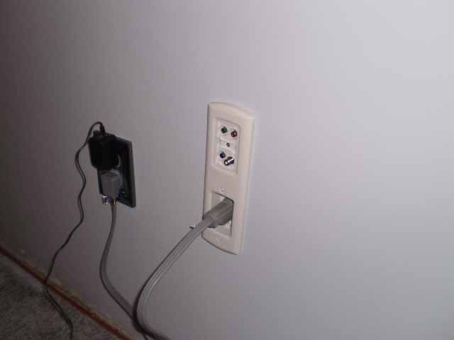

powerbridge-top.jpgLastly I made all my low voltage connections for the Planet Waves component and cableTV cables. These I connected to the rear of the Leviton Quickport jacks. I then made the final connections for the 12/2 (Romex) electrical cable by tightening the three screws on the inlet & outlet. Using the four screws supplied, I fastened each of the completely wired systems to the Single gang box previously installed in the wall. If you have a voltmeter you can use the continuity circuit to test the wiring from point to point before applying power to the system. All that was left was to connect the 36" jumper (extension) power cable to the nearest power outlet on my wall. The system was up and running in no time and I was thrilled with the results. Installation from unpacking to watching my television took just 90 minutes.
The PowerBridge Total Solution Slim-Line In-Wall Power Extension and Cable Kit is a complete and very satisfying product. After working as an electrician for 30 years at Pennsylvania's Bethlehem Steel, and owning my own Home Improvement business, I was pleasantly surprised at the ease of installation and the quality of this product. The process left me wondering why more people don't hide away their cables and mount their flat panels on the wall. I would highly recommend this product to both individuals and custom installers because of its versatility, ease of installation, and the quality of construction. It's simply a solid solution for a common installation situation.
Working with the system was safe, since there was no live electricity to work around. All of the power is supplied when you connect the heavy-duty power cord to the power inlet of the system and then into your existing wall outlet. With this configuration there is no need to run any additional power from another source, saving time and money. Best of all, it means you don't need to hire an electrician to hook up your television properly.
