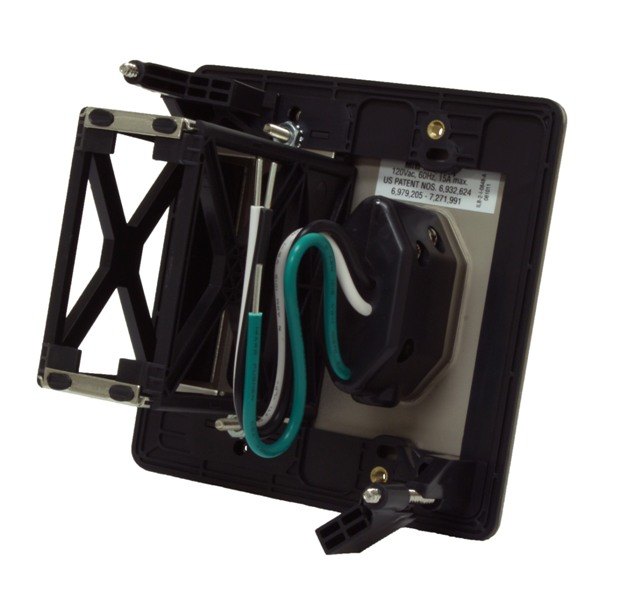

Taking a closer look at the MIW-XT wall plates we find two basic parts, the front plate and the wall mount. The wall mount should look mostly familiar to anyone that has added a low voltage line (like speaker cables) to their walls. It's basically an old work frame. The difference is there is a large cage on one side and a blank space on the other. More on that later. You'll notice very familiar dog ear lockdowns for connecting the frame to the drywall.
The MIW-XT wall plates are constructed out of very sturdy nickel plated steel which means they are rugged, durable... and probably match nothing else on your wall. One side has the power connection while the other has a rubber grommet for cable pass-through. You can cut a slice in the rubber and push your cabling through or use the included keystone adapters for up to two connections (which is not going to be enough more than likely) or replace them with the Decora-style inserts. While you'll be surprised how many connections you'll be able to make with a single insert, it's going to be hard to find anything other than white or ivory. Black is available but you'll most likely have to order it online and usually at a premium. Hopefully, the placement of the wall plates will be somewhere unobtrusive or out of sight (like it was in our installation).

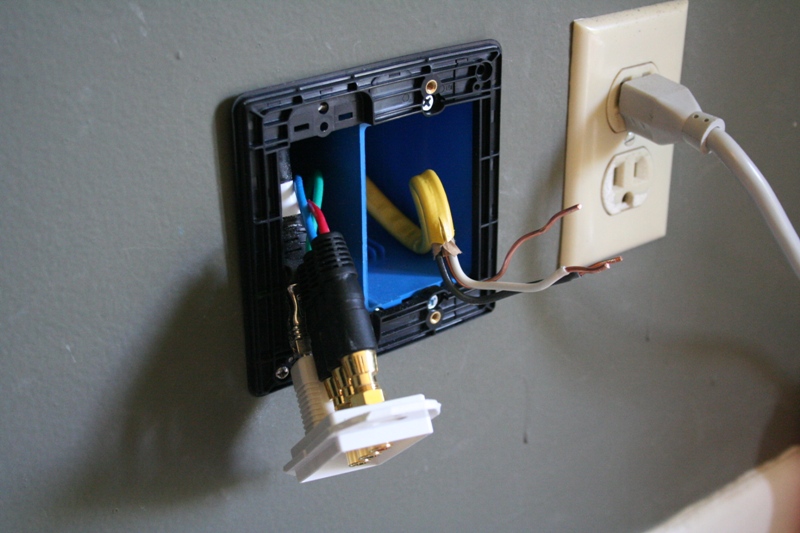

MIW-XT_apartThe hardest part of installing the MIW-XT wall plates is reading through the directions. The mounting plate has a number of accessories and attachments that can be removed or added based on what you want to do. The basic thing to remember is that you do NOT need a back box for the low voltage connections (like video and audio) but you do for the power. For this, you don't need a full double gang box but just a single for the power side. Panamax-Furman recommends:

Once you connect the backbox and run the wires, you'll just need to install the mounting plate on the wall, connect the wires from the power terminal on the faceplate to the 12/2 power cable, the connection on the Decora plate to the wires, and attach the faceplate. We recommend you seriously think about the terminals on your in-wall wire when choosing. A lot of times there is not much room to make the 90 degree turn you need from the back of the Decora plate. For component, composite, 12 volt, and others, this isn't much of a problem. But HDMI has been notoriously unwieldy in such situations. Make sure you have room to make your turn or a cable that is more flexible. Alternatively, you can buy one of those right angle HDMI adapters and use that for the connection. Regardless, careful planning will make this entire process a lot less stressful.

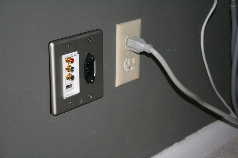

MIW-XT_DoneYou would do well to make all your connections and test the MIW-XT before you install it but you probably won't. We didn't. Running 12/2 power cable is a fairly straightforward and simple process and as long as you don't damage the wire and make good connections you should be fine. As you'd expect, once everything was installed, we had little trouble. Since we hid the plate behind an acoustic panel that had an air gap, aesthetics didn't matter. The three prong IEC receptacle had no problems accepting an aftermarket cable that we purchased for extra length over the one provided.
When connecting the video cables, you're going to want to be careful of the force you use. Many manufacturers get a little overzealous in the tightness of the connection. We've had RCA style connectors literally pull the terminals off the back of a receiver before - they'll have little problem doing the same here if you are not careful. we found that the power connection was solid even if the cord was pulled slightly out from the terminal. This gives you a little wiggle room at the connection point.
Overall, the Panamax-Furman MIW-XT Remote Power kit does everything you want. It may be a little on the pricey side, but it gives you a foolproof and up-to-code way of running power to your display or other devices. It also provides the convenience of the included Decora insert compatibility. While the metal faceplate may not match anything else in you theater (including the Decora faceplate), maybe it won't have to. All in all, it is a very good solution to an increasing common problem.
