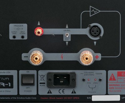

I love the terminations Kimber employs on their cables. From their standard banana to their compression WBT, they look wonderful and perform great as well. The only gripe I found was when using their WBT compression connector, the little plastic post was preventing me from connecting to the Emotiva XPR-1 amplifier I had under review at the time. I quite honestly don’t understand why Kimber even has this piece of plastic which seems pretty unnecessary to me. I had to cut them off with a pair of wire cutters so that I could connect the 8TC cables to the Emotiva amplifiers. Be prepared to do this if you chose this termination for an amplifier with a speaker binding post like the one pictured below.
Emotiva XPR-1 Amplifier Back Panel View
Kimber’s standard banana plug fit perfectly snug on all of my amplifiers and loudspeakers in my reference system. It’s a less costly connector and you can avoid any potential compatibility issues if you just decide to go that route.

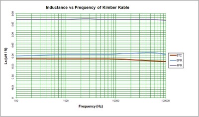

Inductance vs Frequency for Kimber 8TC, 8PR & 4PR
All 3 Kimber models of cable exhibit very low inductance. Due to the braided geometry of these cables, not only are they low inductance, but their inductance profile vs. frequency is ruler flat for the entire audio band. By weight of comparison, the inductance of the 8TC and 8PR was a mere .037 uF/ft and .041uH/ft, respectively; which was nearly four times lower than the 10AWG Bluejeans speaker cables that I revere so much. Interestingly Kimber rates the inductance of these cables as .042uH/ft which is slightly higher than I measured but shows they are conservative in their ratings.

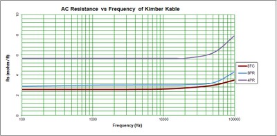

AC Resistance vs Frequency for Kimber 8TC, 8PR & 4PR
Kimber rates the DC resistance of the 8TC cable to be 2.19 mohms/ft while I measured slightly less at 1.72 mohms/ft.

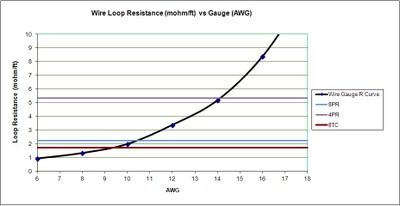

Resistance vs Gauge for Kimber 8TC, 8PR & 4PR
The Kimber 4PR effective gauge is about 14AWG while the 8PR is 11AWG and the 8TC is slightly below 10AWG; the lowest of the bunch. The Kimber speaker cables exhibit a very flat AC resistance profile for the entire audio band. These cables don’t start to show appreciable signs of skin effect (increased AC resistance) until around 50kHz which is well above the 20kHz audio band. At 100kHz, the AC resistance of the 14AWG Kimber 4PR cables is equivalent to the Bluejeans 5T00UP 10AWG cables while the 8PR and 8TC cables exhibit much lower AC resistance. While this is purely academic, it is noteworthy that Kimber products are by design less prone to skin effect than conventional zip cord cables. It’s refreshing that Kimber doesn’t post nonsensical arguments on their website overemphasizing how this parameter can cause deleterious effects at audio frequencies.
