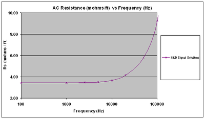

All cable lengths measured were 12 feet and divided by their length for a normalized per foot measurement. At low frequencies the results illustrate Rs being lower than Rdc, which is inaccurate, as Rs tends towards Rdc as frequency approaches zero or DC. The LCR measurement derives Rs from signal phase and amplitude, while a DC meter measures exactly what it is looking for, thus this discrepancy is likely due to a meter resolution issue, as the meter in AC mode does not sport the high accuracy it would in DC mode. The cable should ideally be modeled as multiple parallel resistors, and those resistors treated as a lumped element in series with an ideal inductor.
Each resistor is a frequency dependent element, and the inner ones fall out as the frequency increases. It is important to note the difference in measuring techniques, and caution the reader not to attempt to derive any relationships with the two numbers, as the absolute accuracy between the methods has not been established. However, the rising trend of Rs vs frequency is indicative of increased Rac due to skin effect and should also be noted.

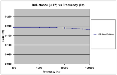

Inductance measured similarly to 12AWG Monster cables from Speaker Cable Face Off I . We see a minimization of internal inductance due to skin effect at frequencies above 20kHz. While this is measurable, it is not something that cannot be sonically detected in real world audio application nor is it cause for alarm since just about every speaker cable we measured, regardless of their price, appearance, or claim to fame for resolving skin effect exhibits similar behavior.
For a more detailed discussion on cable inductance, the reader is encouraged to review our article on Calculating Cable Inductance

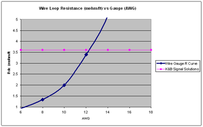

The resistance of the K & B Signal Solutions Concert Series cable is about 12AWG at DC.
We see a rising AC resistance with frequency of about 20% and 20 kHz, again attributed to skin effect, but practically speaking a non issue for the application of high fidelity audio.

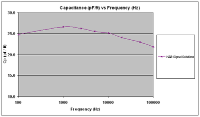

Capacitance about on par with 12AWG Monster Cable from Speaker Cable Face Off I . We see the capacitance decrease with frequency for two reasons, slight instrumentation error of measuring a distributed device (speaker cable) with a measurement tool designed to measure lumped elements (magnetics, electrical circuits, etc), and a decreasing dielectric constant with frequency. While many esoteric cable vendors and cable cult hobbyists would have you believe this is considered Dielectric Absorption and will again cause audible distress, the reality is most cables exhibit this behavior and it is not something that will cause deleterious effects on fidelity or performance of even the most demanding and revealing audio systems.
For more information on Dielectric Absorption, see our article entitled Debunking the Myth of Dielectric Absorption
