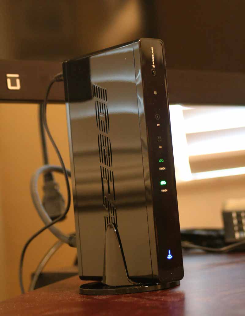

wireless HDMI transmitterIt doesn't just stop there, though. It also takes any composite, VGA, or component video source and upconverts it, if needed, to HDMI. The included remote let's you switch between sources, even allowing you to mix and match audio and video. This means that your legacy A/V receiver might have just gotten some new life out of it while you're saving the hassle of installing HDMI cabling.
IOGEAR’s Wireless HD Kit can actually stream 1080p/60Hz video and audio content up to 100 feet away. We tested it as far as 30 feet, and even put the receiver behind the TV without any difficulties in reception. Standing between the transmitter and receiver didn't seem to affect it and the unit has two different frequencies it can use to help it navigate any potential difficulties. It also offers the added flexibility of a RJ45 LAN for those needing to go further than 100 feet. This essentially turns the system into a fancy HDMI-to-Cat5e/6 balun.

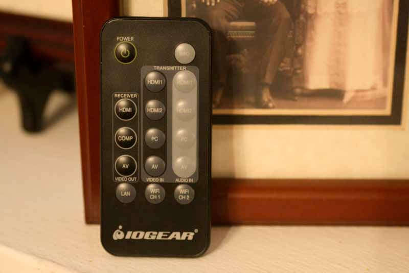

remote controlOne of the features we really loved about the IOGEAR Wireless HDMI Kit was that it came with the ability to receive IR signals at the receiver and send them back to the transmitter. This is a common issue, since many people are using wireless HDMI precisely because the source components are relocated from the display. Because of IOGEAR's emitter system, you can potentially point the remote at the TV and still control all of your A/V hardware. Speaking of remote, IOGEAR's included credit card-style remote allows you to select your audio and video sources independently and send them to your selected output of the receiver. This is not only convenient, it allows, as we hinted at earlier, older AV receivers that are pre-HDMI to remain in your system and still interface with a newer HDMI-capable flat panel display.
