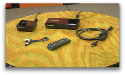

What if you could send an HDMI signal to your second TV without having to buy a bunch of wires. Or watch HD movies in your bedroom without repurchasing more Blu-ray players or leasing more DVRs? Or, what if you have a new TV but, for whatever reason, you can't run wires to it - maybe because it's on a different wall from your gear, or you're renting. Those are the problems IOGEAR was solving when they released their new Wireless 3D Digital Kit. The kit comes with a 2-input transmitter and a small receiver that can mount underneath or even behind a flat screen TV. Both units require external power and, as of right now, the system is designed so that only one receiver can be connected to a transmitter.

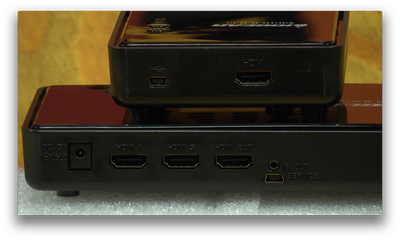

There are a few interesting features of the GW3DHDKIT. To start with, the transmitter has two inputs and a single output. Dual inputs means you can feed the unit two sources, like a DISH DVR and a Blu-ray player. The output, however is unusual on devices like this. It means you can also output a signal to your local television. So, really, you can continue to use a local TV while you also transmit signal to a remote display. If you have an A/V receiver, you can send it's HDMI output to one of the inputs of the Wireless 3D Digital Kit. That way you can utilize all the extra inputs of your receiver and make the system even more flexible.

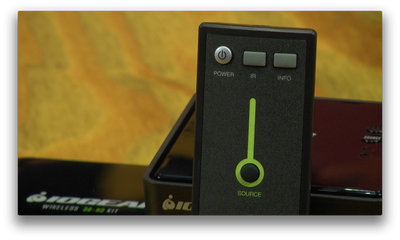

The GW3DHDKIT also has a nice feature controlling your gear remotely. The transmitter which sits near your gear comes with a triple IR emitter, so that it can talk to your equipment. The receiver, which might be located under a TV in an adjoining room, has a built-in IR receiver. So you can take your remotes with you and control your gear from the other room. Very cool. About the only suggestion we'd have for IOGEAR is that they think about a product that allows for multiple receivers. Imagine this technology in a whole-home video application? Still, at just under $200 retail, the IOGEAR Wireless 3D Digital Kit is both affordable and fully featured enough to appeal to just about anybody.
