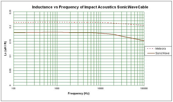

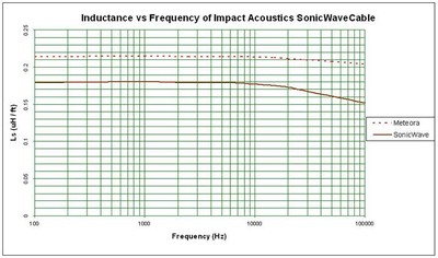

SonicWave inductance vs. frequency
Figure 1. Inductance vs Frequency of SonicWave Cable
One of the benefits of using lower gauge wire spaced closely together is reduced inductance as can be seen in the comparison of the Meteora (12AWG) vs the SonicWave (10AWG) cable in this example. Inductance was about 16% lower on the SonicWave Cable (around 0.18uH/ft) compared with their Meteora cable previously reviewed here. We like to see cable inductance below .200uH/ft to minimize high frequency rolloff for long cable runs and SonicWave comfortably meets our criteria. The slight decrease in cable inductance above 20kHz is a result of minimized internal inductance due to skin effect. This is an inaudible and barely measurable phenomenon and is only discussed herein for academic purposes.

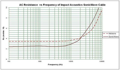

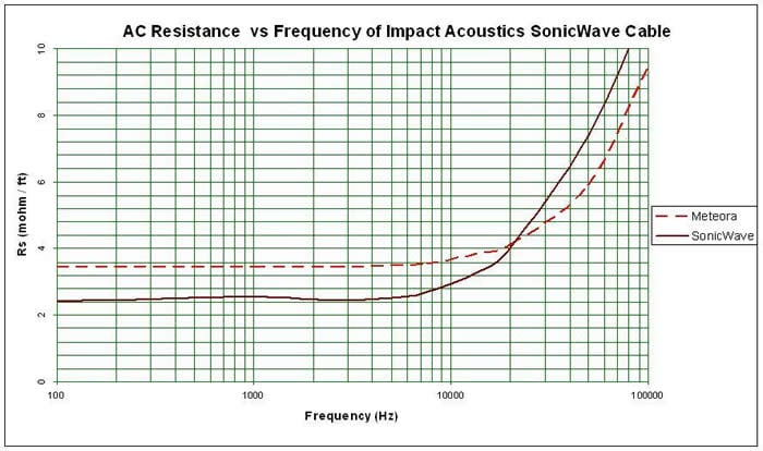

Figure 2. AC Resistance vs Frequency of SonicWave Cable
The resistance of the SonicWave measures just below 2mohms/ft (1.87mohm/ft actually) which represents an equivalent effective gauge of around 10 AWG at DC as specified by Impact Acoustics. This is a very low resistance speaker cable making it ideal for long runs throughout the home with minimized losses. We see a rise in AC resistance with frequency above 20 kHz attributed to skin effect, but practically speaking a non-issue for the application of high fidelity audio. What's important is the AC resistance at audio frequencies is appreciably lower on SonicWave than the Meteora cable, though both cables have excellently low AC resistance, significantly lower than many costlier esoteric designs that claim to "reduce" skin effect.

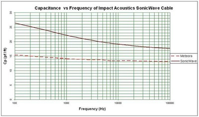

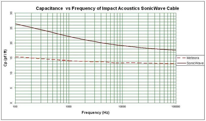

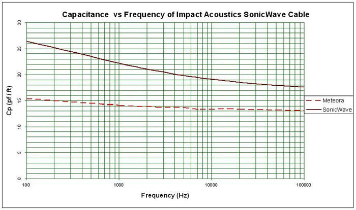

Figure 3. Capacitance vs Frequency of SonicWave Cable
Capacitance was very low, weighing in around 20pF/ft only slightly higher than that of the Meteora speaker cable. We like to see cables measure under 50pF/ft, a spec which SonicWave comfortably meets. This ensures there won't be any stability or frequency peaking issues for long runs on marginally stable amplifiers with high unity gain crossing, or excessive high frequency rolloff on amplifiers with high output impedances driving a reactive loudspeaker load. The reason for the slight decrease in capacitance with increasing frequency is likely attributed to measurement error of measuring a distributed device (speaker cable) with a measurement tool (Magnetics Analyzer) designed to measure lumped elements (magnetics, electrical circuits, etc). Rest assured this cable has very low capacitance and can be connected to virtually any amplifier without risk of loss of stability or frequency peaking or roll off regardless of amplifier characteristics.
