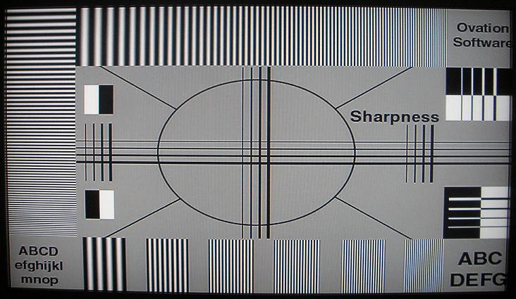

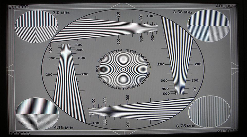

Starting with Avia Guide to Home Theater Chapter seven, we selected the 100TVL resolution test. With the resolution pattern displaying on our Olevia 532H LCD HDTV, we carefully viewed the image. We found that the 65-foot cable run transmitted the up-converted 720p signal flawlessly. The line structure present in the horizontal and vertical resolution wedges were easily discernable and reproduced accurately. The static zone plate looked clean, sharp and well focused. We decided to try different resolutions of 480i, 480p and 1080i. Each resolution synced perfectly between the DVD player and the HDTV. Moving to the Sharpness pattern, we viewed no excessive ringing, flickering, or ghosting on the displayed image. We thought a subjective A/B comparison between the very good 10-meter Impact Acoustics SonicWave HDMI cable and the 65-foot RapidRun Digital cable would be helpful in determining if any softening was occurring in the displayed resolution images. We viewed each image several times disconnecting one cable and swapping it out for the other. We could view no discernable differences between the 10-meter Velocity HDMI cable and the Active RapidRun Digital Cable System. The RapidRun Digital Runner Cable’s 24 – AWG wire size and the Active Wall Module obviously had a significant role in the performance level obtained by the system.

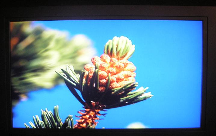

noiseredNext, we wanted to see if the 350 watt power supply in the running desk top PC that we connected to the outlet could breach the shielding capabilities of the Digital Runner Cable. Remember that we wrapped the cable around the 115-volt Romex wire run circuit. We were unable to detect any noise in the static Avia resolution tests but we wanted to confirm our findings using the HQV Benchmark DVD noise test. We first viewed the noise test with the active 65-ft RapidRun Cable, and then switched to the 10-meter Velocity HDMI cable. Although the test is subjective, we could view no appreciable differences in the image quality between the RapidRun Cable that we wrapped around the Romex and the 10-meter Velocity HDMI cable that was not. Our findings indicate that the RapidRun Digital HDMI Cable System has stellar shielding properties. Home theater pre-wire should always be routed correctly but in a typical installation we think RF and AC noise ingress is unlikely with the RapidRun Digital Cable System.
