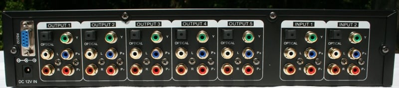

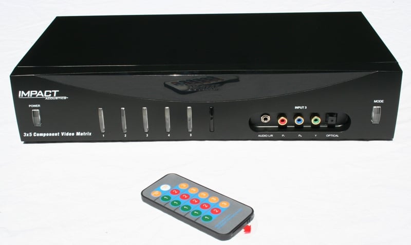

Taking a closer look at the 3x5 component switch, there is a power and mode button on the front as well as five lights and Input #3. Each input (either front or rear) has a set of component inputs (red, green, blue) for your video and a TOSLink optical input for audio. The two inputs on the back have red and white RCA style inputs for analogue audio and the front input has a 3.5mm jack for analogue stereo input (presumably to save space). All five inputs have component, RCA style analogue audio, and TOSLink digital optical outputs. Lastly, there is an RS-232 serial port on the back for direct control.

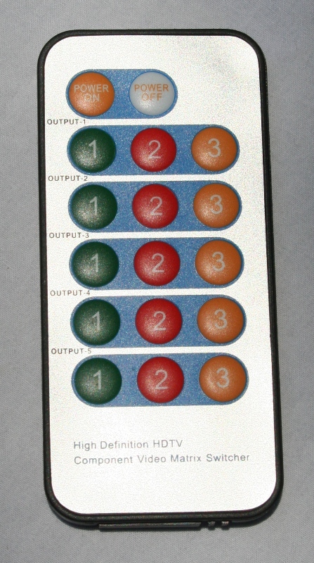

3x5_Back.JPGThe manual is basic and adequate. The remote is of the type that I expect with switches these days - small, plastic, and easy to lose. The remote has dedicated on and off buttons (great for integration into a control system) and a set of three buttons for each output. Each set of three buttons is labeled for each input and color coded - green for one, red for two, and orange for three. The remote has great off axis response and was very quick.
Setting up the 3x5 switch is really as easy as connecting a couple of cables. It is important to note here that the switch does NOT convert analogue audio to digital - only audio switching is supported. This means that you'll need to maintain the proper connections if you are going to change up the types of audio you are sending to the switch. Once you connect up your three sources and five displays (you did remember to write down what went where, right?), it is just a matter of deciding how you want your audio and video routed. Remember that the audio is always tied to the video source so you can't select video from Input 1 and audio from Input 3.

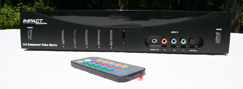

3x5_Remote.JPGThere are two ways (well three if you count the RS-232 port) to control the 3x5 Component Video Selector Switch - from the front or with the remote. If you remember, I mentioned that there were five lights on the front that are assigned to each output. Well, these are not only lights but also buttons. Each time you hit one, it cycles to a different input. Each input is assigned a color on the front of the unit. The colors (you've guessed this by now haven't you) correspond to the colors of the buttons on the remote. So you can tell by looking at the front of the unit which outputs are getting Input 1 by counting the number of green lights, Input 2 by the number of red, and Input 3 by the number of orange. The Mode button cycles all outputs at the same time to the same input starting with the next input after the last time you hit the button. So, if the last time you hit the button all the outputs switched to Input 2, the next time you hit it they will all switch to Input 3. Hit it again and they all flip back to Input 1 - very convenient.
The thing to realize about the 3x5 component switch is that all those individual buttons on the remote translate into discrete codes. That means that you'll be able to integrate this into any automation system including RF and IR-based universal remotes. You'll be able to direct each output to the appropriate input without having to deal with the hassle of a single code that is used to cycle through the inputs. This foresight by Impact Acoustics elevates this device from an "Oh that's nice" to "Wow, I can really see the possibilities of that." Even using the most basic of universal remotes, it would be easy to program in any number of different configurations based on time of day, devices used, and just about anything else. The only real omission here (or on the device in general) is a discrete IR input. RS-232 control is nice, but you are relegated to using an IR flasher if you are going to integrate it into a typical universal remote system.
