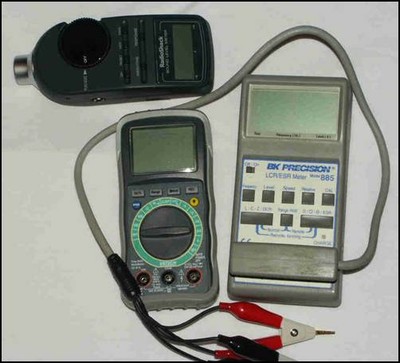

I have always had a bigger is better philosophy, as well as a devote DIYer. So after reading all I could about speaker cables, I started on my path to building a bigger (and better) mouse trap. I wanted diameter as well as performance. I also had the tools to determine which was better. I have my own LCR meter, a BK Precision Model 885. Granted this is no Wayne Kerr model 6420 with unobtanium leads and a $15000 price tag like Audioholics uses in their Test Equipment Arsenal, but it is suitable for most home grown/military applications and cost less than $1000. Not much less, but less (even with the Kelvin clips). Nor does it generate gigahertz frequencies, it maxes out at 10000 Hz. Which is fine with me, after all I cannot hear anything over 16000 Hz so why test speaker cables at 1 GHz? Video cables are another matter, but not in this paper.

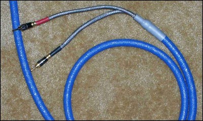

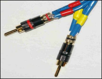

Unless otherwise stated, all cables were finished with WBT Clone, crimp style, locking banana plugs (see Figure 1).
FIGURE 1
WBT Clone (GLS) Locking Banana Plugs use for all cable ends

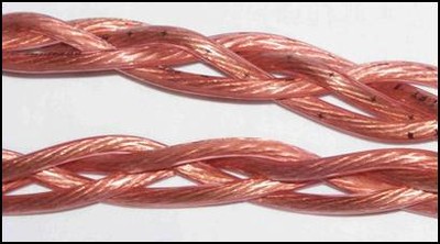

I have read about using cat 5 wire as a speaker cable, but I was not that interested in braiding all those tiny wires hundreds of times. Then I though that since the wire pairs run rather loosely inside the outer covering, how would they test out if I made speaker cables using the entire package? Since cat 5 is just a twisted bunch of 24 gauge wires, I figured that 16 wires was roughly equal to 12 gauge litz wire and 24 wires was roughly equal to 10 gauge litz wire, viola, 4 and 6 individual lengths of cat 5 would be all I need. I took about 100 feet of cat 5 wire where I work and cut it into 10 foot lengths, attaching all wires (left inside the sheath) to banana plugs (see Figure 7). The prices shown in table 5 are based on prices from Parts Express and the number of 10 foot lengths used and does not include the connectors. I used these cables in five different variations using 4 or 6 cables. See Figures 2 through 6 for descriptions.
As I started with many 10 foot lengths, the overall length of the speaker cable was somewhat shorter after twisting and braiding. This shorter length of each version is used below when determining Rs, Cp, and Ls on a per foot basis.

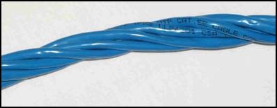

FIGURE 2

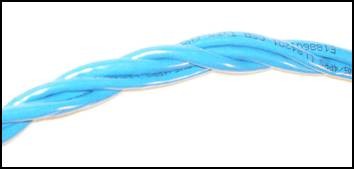

CAT 5 - V1 Four Twisted Cables

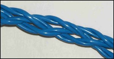

FIGURE 3
CAT 5 - V2, Four Cables Braided
FIGURE 4

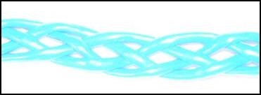

CAT 5 - V3, Six Twisted Cables
FIGURE 5

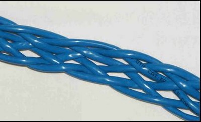

CAT 5 - V4, Six Cables Braided
FIGURE 6
CAT 5 - V5, Six Cables in Three Twisted Pairs Braided
FIGURE 7
Typical Cable Ends Finished for Testing

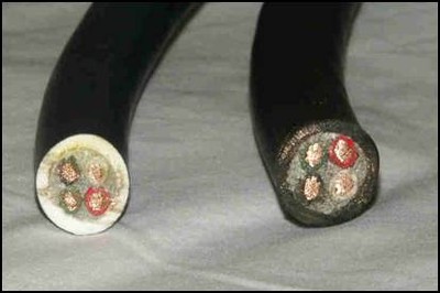

Generic
I do not know the brand name of these cables, but they are available at Lowes. The 10/4 cost $1.74/ft and the 12/4 costs $1.46 per foot. I purchased these after being very impressed by the supple feel, flexibility, and large diameter. Both cables have some sort of polyester fill between cables, and the 12 gauge cable has a white polyurethane sheathing inside the rubber external sheath. Both cables have the same OD. 20 feet of each was purchased and the entire length was used in testing.
