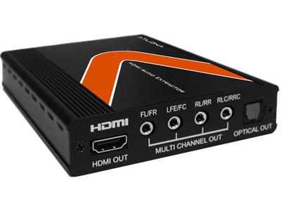

AT_HD570_backThe AT-HD570 HDMI Audio De-Embedder works with HDMI 1.3 and will strip the audio portion off while maintaining the video. You can output the audio either via TOSLink or analogue while sending the video to your display via the included HDMI output. The analogue outputs might look unfamiliar to the general AV populace as it takes the form of four 3.5mm jacks. This is common in the computer world and requires only four 3.5mm to dual RCA cables to make the switch.
The technology isn't without its limitations, however. The optical output only supports Dolby Digital 5.1/2 or LPCM 2.0. No word yet on if DTS is supported but we're guessing it isn't. Through the analogue outputs you can get the whole she-bang - as long as you are decoding at the source and sending 7.1 LPCM. While it makes it sound like it removes the audio from the HDMI feed, it really doesn't. Through the HDMI you can get all the audio formats either LPCM or bitstreamed.
The AT-HD570 is HDCP compliant so you won't have to worry about it working with your other HDMI devices. It can serve as a repeater as well. It has onboard HDMI signal amplification and reclocking. Deep Color is supported from 25MHz to 6.75GHz for 36 bits and resolutions up to 1080p (24 or 60 Hz). The video is passed through untouched - the AT-HD570 doesn't scale or upconvert.
