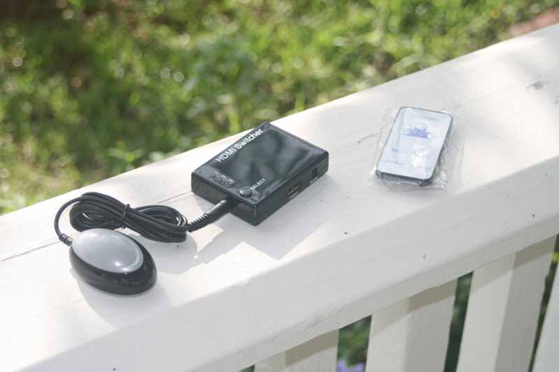

Apogee mini switcherLet's start with the most compelling of the sample products we received. The 3x1 HDMI mini switcher is tiny in size and really seemed like a useful "on-the-road" device that could come in handy if you need a simple switching solution that doesn't require a discrete power supply. The box comes with an IR receiver and remote control - all of which aren't required since the unit can function by using its top-mounted Select switch. It would be a handy device if you needed something to hide away or mount behind a flat panel, but realize that it has no keyhole mounts so it is more of a "connect and let dangle" product. The remote worked well and the features packed into such a little box are compelling. The switch looks to actually be manufactured by Hong Kong Mealink Electronic Industrial Co., Ltd in China and resold by Apogee without any branding or alterations. The bulk price of the unit is around $15, so resellers should be able to pick thee up for a reasonable price. Apogee doesn't list retail pricing online until you are approved on their website.
