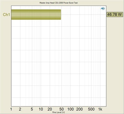

  • All tube 30 Watt Class A power amp with 4-EL84/6BQ5 and 3-12AX7 preamp tubes

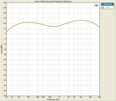

  • Speaker driver linearity could be improved
  • Spike in low midrange response could not be resolved using tone controls on amp head
  • Very low volume bass response
