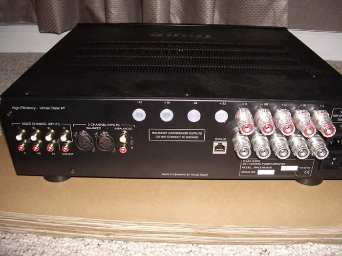

The Thule PA350B is a rather unique amplifier in the sense that it is the first I've run across with 3 power switches! That's no typo, there is a Mains power switch located on the back of the chassis, a Fault switch located below the unit, and a Stand By front panel power switch. I can appreciate the manufacturer's passion for safety, but I found the bottom chassis fault switch to be more of a nuisance than a benefit, especially after I loaded the unit in my Middle Atlantic Rack and found out the hard way it wouldn't power up because I accidentally disengaged power to the fault switch when installing the 48lb amp at the top of my rack.
According to the manual, the PA350B requires an unusually long 2-4 hours to warm up and reach peek performance if cold started from the mains power switch, but only requires 10-15 minutes of warm up time if the unit is left in standby mode and then becomes active. While I can understand the benefits of allowing an amplifier to reach thermal equilibrium, I am uncertain as to why it would take as many hours as the manufacturer claims from a cold start. Nonetheless, I left the amp on for several hours before engaging in any critical listening tests or undergoing my power measurements.
The PA350B can be triggered to toggle between 2CH and 5CH mode in three ways:
  • Auto sense mode - if it detects signal on center channel it automatically switches to 5/7 CH mode
  • Manually on front knob by pressing the 2CH/5CH button
  • Their proprietary data port which interfaces with their matching preamplifier
One operational quark that irked me regarding the bridged 2CH mode is that the unit automatically reverted back to balanced inputs each time it was power cycled. Since I wasn't using their matching preamp to provide it data logic, I had to use some nifty Impact Acoustics unbalanced to balanced cables between the preamp of my Denon AVR-5805 receiver to this unit to always ensure I had audio signal present.
The PA350B sports all high quality WBT style banana speaker terminals and gold plated RCA jacks with two balanced inputs for the high power 2CH bridged mode. It has no 12V trigger options (a disappointment to me) though the unit can be trigged via the proprietary data port connection if you are using their matching preamp. The S1 & S2 connections are intended for upgrading this unit to 7 channels of amplification.
