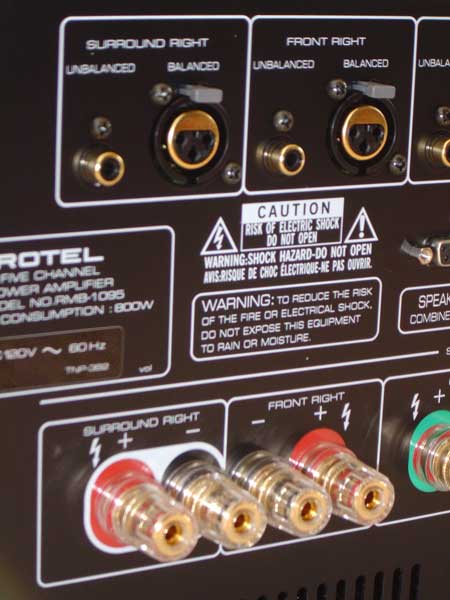

Rotel RMB-1095 connectionsRear Panel & Connections
Taking a look at the rear of the Rotel RMB-1095 will show off the high-quality WBT 5-way binding posts. These are the premium kind, and really do a lot to dress up the rear of the amplifier. In addition, should you choose to utilize bare speaker wire, the holes in each of the speaker connector shafts are situated so that all cables will be vertically-oriented - a nice touch, resulting in a cleaner cable assembly.
The RMB-1095 allows for both balanced XLR and unbalanced RCA input signals, so if you have a high-end processor with balanced XLR outputs you can maximize your potential. One additional input option is the DB25 connector which is essentially a neater way to integrate five unbalanced channels. Primarily used in custom installations, this connection must be used in conjunction with five open-circuit RCA plugs which ensure proper impedance.
A 3.5mm 12V trigger connection for the amplifier is provided. It accepts anything from 3-30 V and must be engaged via an on/off switch. There is also a 12V trigger output jack for daisy chaining the 12V signal to other components. To use the 12V trigger, the amp must be on. Disengaging the front power button turns off all power to the amplifier regardless of trigger inputs.
