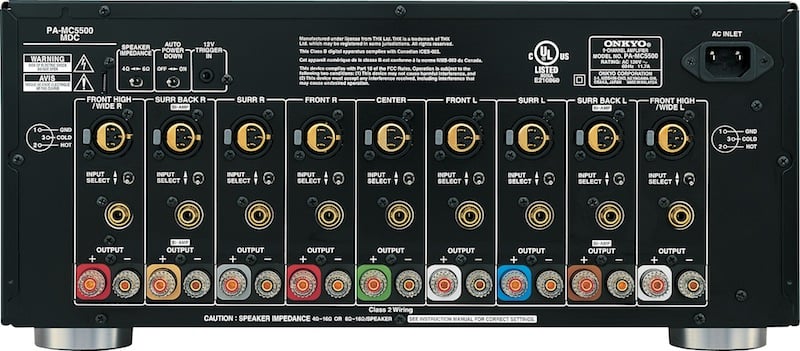

pa-mc5500_rear
The first thing we noticed about the back of Onkyo's PA-MC5500 is that they decided to go with a two-prong power cord. While you can make any power supply and grounding system work well, this method typically yields less ground loops in our experience. The PA-MC5500 has nine channels of amplification rated at 150 watts each at 8 ohms. You'll notice in the specs above that the amp is rated at 6 ohms to 220 watts. This is because the PA-MC5500 hasn't made it to the US Onkyo site yet and we pulled the specs from the UK version. Yes, this amp has been out for a little while,  but here in the states we haven't had a chance at it yet. We can take the UK specs as a guide, though, as a the reported dynamic power into 3 ohms is similar.
It seems that Onkyo has rated their amp driving a single channel into 1kHz. While this isn't exactly an invalid measure, it is one of the easier tests. The amp has a massive power supply consisting of a large toroidal power transformer and two 22,000 µF storage capacitors and utilizes Onkyo's proprietary WRAT (Wide Range Amplifier Technology) architecture. WRAT focuses on low negative feedback, low distortion, extended frequency response, and a power supply with high instantaneous-current capability. To achieve all this, the PA-MC5500 uses large, custom output transistors in push-pull configuration. It also has a three-stage inverted Darlington circuit to remove distortion.
As you can see from the back panel, the PA-MC5500 has gold-plated inputs and outputs including professional-style balanced line-level XLR inputs. There is a 3.5mm jack for 12volt control and a 6 or 4 ohm selector switch. We would have thought they'd change that to an 8 ohm/4 ohm switch for the US market (and UL) but apparently not. There is an Auto On/Off switch which allows you to let the amp power itself down if it doesn't receive a signal for a while. There are two things we like about this function on the PA-MC5500. First, the 12 volt trigger completely defeats it. Second, the power light will flash for 10 seconds before it automatically goes into standby mode. This gives you a heads up in the case of a problem. Onkyo admits in its manual that, "Depending on some sources, the auto power-down function may activate during playback." Umm... OK. At least they're upfront about it. While the size and number of channels might suggest that the PA-MC5500 is a digital amp, it isn't. It's an all-analogue solution which is confirmed by its 51 lb weight. While not heavy by some amp standards, it does suggest that the extra bracing for their "rigid, anti-resonant chassis" is in place.
