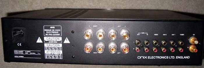

Setting up the A-120 M KII couldn't be easier. It had a very basic back panel with 5 audio inputs, a tape monitor, and four sets of WBT binding posts to power up to four speakers via its internal two-channel amps. The speaker outputs are wired in parallel so if you do plan on taking advantage of all four outputs, we would advise using 8-ohm minimum loudspeakers since the amplifiers will actually see half that impedance when driving two 8-ohm speakers per channel. Otherwise, feel free to use 4 ohm speakers in a two-channel configuration. As you will see in our bench tests, this amp has plenty of drive and will not hiccup on difficult speaker loads.

The thicker solid copper RCA connectors for the CD input add a nice touch of nostalgic value for audiophiles concerned with such matters. I like them because they were firmly coupled to the chassis - easing my concern when attaching and removing even the most exotic and not-so-form-fitting interconnects without fear of breaking them off.
Though I am not a Vinyl fan, lovers of this format should be aware that the Onix A-120 M KII does not contain a moving coil phono preamp. Thus, you will have to add your own and attach it to one of the unused inputs. I don't see this as an issue since true phono fans can always be found chatting up their favorite outboard preamp.
