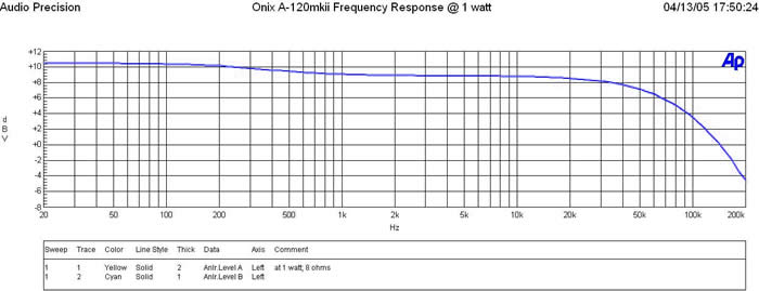

Frequency response at 1w
The Audio Precision revealed one reason I was hearing authorative bass impact and a warm sonic signature. There was a +2dB bass boost built into this amplifier out to about 200Hz or so. This was obviously a deliberate design attribute which can also be inferred by their published frequency response specification from 20Hz to 20kHz +-1dB. I can't really fault them since it was in fact intended and I did find it pleasing to the ear despite it not being the normal ruler flat response typically found on most consumer gear.

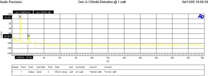

distortion at 1 watt
Distortion at 1 watt was respectable (+8.332+68.583)dBv = 76.915dBv or 100*alog(-76.915/20) = .014%.

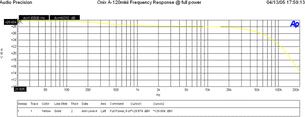

Frequency response full power

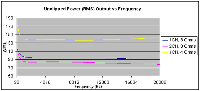

unclipped power
At full unclipped power, the Onix A-120 M KII delivered about 116wpc into 8-ohms but with the caveat of it being a function of bandwidth. From 20hz to 200Hz it delivered about 30Vrms (116wpc) via 8-ohms for .1% distortion and 26Vrms (85wpc) at 1kHz when fed the same input signal level but at a much lower distortion level. Into 4-ohms the Onix A-120 M KII delivered about 170wpc at .1% THD from 20Hz to 200Hz and roughly 115wpc for the rest of the audible spectrum. Since Onix doesn't specify distortion over a specific bandwidth for their power specifications, we can't declare they didn't meet them. We didn't run into any situations where we felt the amp was short of power during our listening tests.

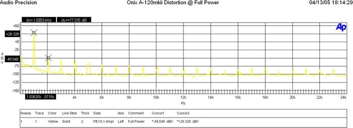

distortion full power
Distortion at full power was good, though higher order harmonics were more pronounced; (+28.328+49.048)dBv = 77.376dBv or 100*alog(-76.915/20) = .014%.
