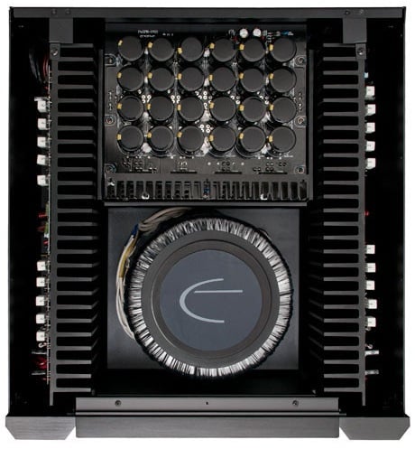

To start with, you get 600 discrete watts into 8 ohm both channels driven or 1000 watts into 4 ohms. That's a huge amount of power. It sports a 2.5 kVA toroidal power transformer which alone weighs 30 pounds. This is connected to a 240,000 uF low ESR capacitor bank feeding a pair of optimized class H power amplifier modules. Class H assures high efficiency and low heat, meaning more of the power from the wall outlet is converted to watts to your speakers than conventional Class A/B designs. According to Emotiva, the XPR-2 "Effortlessly drives complex speaker loads with ease; stable with virtually all real-world speakers." All in all, the XPR-2 is 17" wide, 9.5" high, 19.5" deep and weighs in at 100 pounds—an amplifier not for the weak of back.

The front of the XPR-2 has dimmable blue lights with a fully controllable LED bar graph metering system with selectable ballistics; VU and peak reading with auto release. There are also channel state LEDs which indicate high temperature and fault conditions. The soft touch power button powers on the unit while in-rush limiting protects your gear and speakers. The front of the XPR-2 features a precision machined, 1" billet aluminum, multi-element faceplate with laser embossing and hand polished detailing. This is truly a reference quality amplifier.

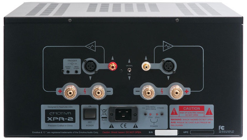

The back of the XPR-2 has independently selectable balanced (XLR) and unbalanced (RCA) inputs for both channels. The Emotiva speaker binding posts have clear acrylic insulators and heavy duty gold plated contacts. There is a button to select 115 VAC or 230 VAC for worldwide use.  Due to the high current in the power supply, you have to select the mains voltage with a switch.  Emotiva does not use the auto-commutator on the XPR Series. Nearly all models self select, and ALL products are "world" products, designed for use in all markets.
There is also a trigger input and output. The only downside to the XPR-2, other than the weight is the power requirement. From their website:
The XPR-2 requires a 20 Amp circuit and standard IEC 20 Amp outlet (which is different than a 15 Amp outlet). If you don’t have a proper circuit and outlet, we recommend you have one installed by a qualified electrician. We recommend that the XPR-2 be plugged into its own dedicated 20 Amp circuit.
