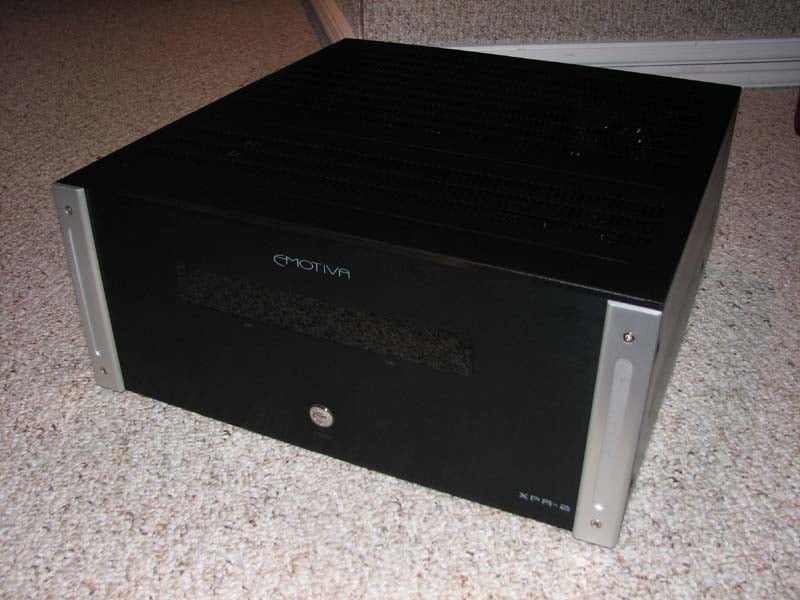

front.jpgA little over a year ago I spoke to the Dan Laufman, President of Emotiva, about making a balls to the walls two channel power amplifier for under $1k that would utilize a single massive power supply instead of mono block construction like the RPA-1. His reply was “no I can’t do it for $1k, but I can do it for around $800.” I dared him to make it happen and thus the XPA-2 was born.
When the preliminary specs were leaked to me, I scratched my head in wonder of how they could make such a high power amplifier that bellies its asking price. If this thing measured well, it would redefine the budget amplifier market and bruise the ego of pricey and more prestigious brands. When the 80+ lb XPA-2 arrived at my door, I was eager to hoist it up the flight of steps in my reference room, despite a battered back with five bulging discs. The show must go on, no matter the personal sacrifice, as my curiosity far outweighed my common sense of asking for assistance. I was determined to find out what level of quality one could expect from this monster budget amplifier. But, if you wanna know the scoop, you’re gonna have to read the entire review. No instant gratification will be awarded in a one sentence summary here.

xpa2_LEDs.jpgThe XPA-2 is one hefty amplifier to lug around. When moving it between my rack and test gear, I found it easier to turn it upside down and slide it across my carpet for which my back thanked me. The ergonomics of this amp is quite excellent. The front panel has the classic Emotiva illuminating power switch which glows amber when in standby mode and blue once powered on. The power LED’s illuminate blue when the channels are on and the power meter illuminates blue up until the last couple of dots which illuminate red indicating possible amplifier clipping. The built in fault projection, designed for short circuit conditions or amplifier overload will make all of the LED’s of the respected fault channel blink red which can be reset by simply power cycling the front power button. I only ran into this situation on the bench and NEVER during real world listening tests.

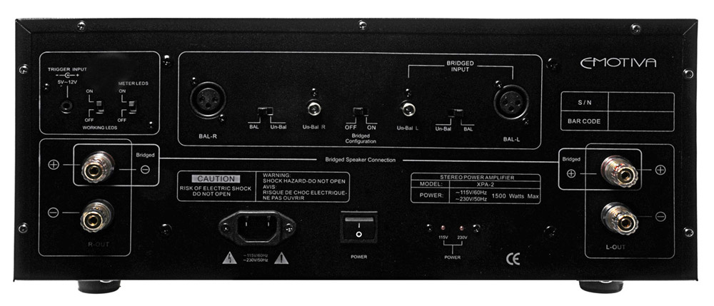

Everything on the back panel was clearly labeled, especially with respect on how to bridge the amplifier. The bridged input and + and – speaker terminals were clearly labeled, a lesson Denon could learn in their POA-A1HDCI 10CH amplifier. There is a 5-12V trigger and toggle switches to turn on/off the LED indicators and power meters as well as switching between bridged and balanced XLR and unbalanced RCA input connections.
XPA-2 back panel view

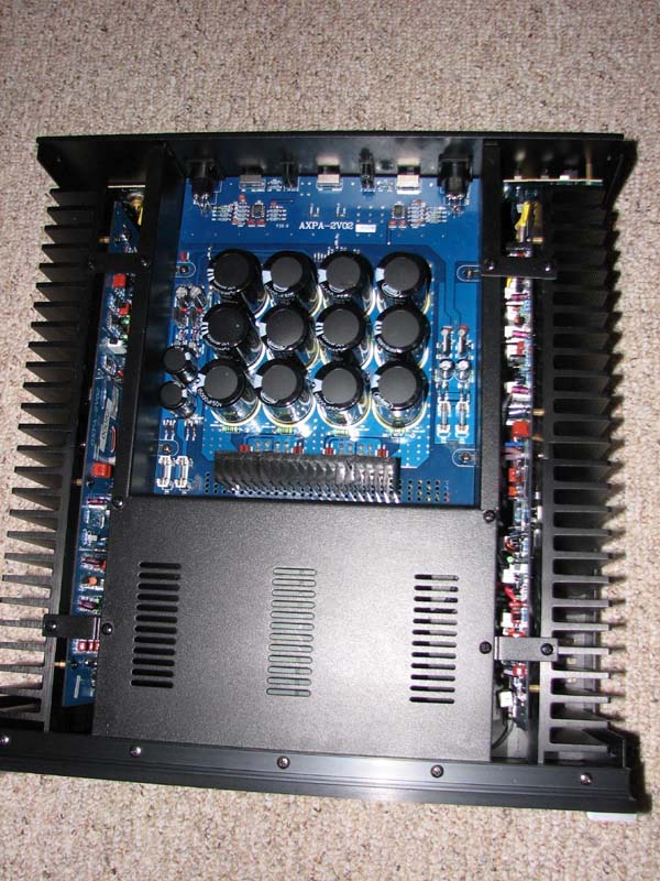

XPA2-top.jpgThe XPA-2 is a traditional class A/B design whereas the RPA-1 and MPS-1 are multi-rail class G design schemes. Both are sound designs whereas the A/B’s tend to be a tad more linear at the expense of efficiency. Despite the fact that Class G designs have come a long way, virtually eliminating diode rectification issues thanks to the usage of Schottky diodes with lower forward voltage drops, Audiophiles still prefer traditional class A and class A/B designs. I can understand Emotiva’s move back to the class A/B design in this capacity and, as you will later discover in this review, they took care in squeezing out as much efficiency as possible while also ensuring the amplifier runs cool during large power emands.
Unlike past Emotiva amps which have traditionally been mono block constructions with independent power supplies for each channel, Emotiva instead employed one large central power supply for all channels. This design philosophy is carried through for all XPA series amps such as the 3 channel XPA-3 and 5 channel XPA-5. While the advantage of truly mono block designs often is superior channel to channel isolation, you can achieve very good, and often nearly equal results having a single centralized power supply but with one huge advantage - more headroom available to any single channel since each channel now has the ability to tap from one larger supply. This is the methodology I usually prefer as I am all about headroom in amplifiers.

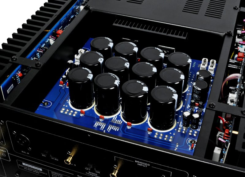

Emotiva claims the XPA-2 has a total of 120,000uF of power supply capacitance. Even if all 12 of these 50V 15,000uF capacitors were wired in parallel, it would add up to 180,000uF, NOT 120,000uF so I am not sure where they got this figure from. What Emotiva isn’t telling you, is that these caps are NOT all wired in parallel like most amplifiers. They can’t be parallel connected because this amplifier is rated at 250wpc into 8 ohms requiring at least 71V caps to achieve this power rating. Instead, Emotiva is wiring them in a series-parallel combination so that the total effective power supply capacitance is ¼ what it would be if they were all wired in parallel, but provides a potential of 100V storage to drive the rail voltage up high enough to meet their power goal. Thus this amplifier really has an effective storage capacitance of 45,000uF, NOT 120,000uF which is still very adequate for this amplifier. According to their website, the power transformer is rated for 1.6kVA while their user manual states 1.2kVA. Considering the max power consumption is 1500 watts, I’d tend to think the 1.2kVA rating is the correct one yielding a power factor of around .8. This is quite a massive power supply for a multi-channel amp, let alone a 2 channel amp costing well under $1k. I’d call shenanigans on their specifications, but considering what this amplifier offers for the money, I’d instead chalk it up as typos on their website which they can now go back and review.
XPA-2caps.jpgA peek under the hood reveals why this amplifier is so heavy. It’s got a lot of metal, heatsink area that is. Coupled with 12 output devices per channel and the aforementioned power supply, this is a solid receipt for stable high power delivery. I was simply amazed by the construction quality and that it utilized such massive tapered heat sinking. This is not something you find in amps at double the price demonstrating Emotiva has really put together a fine wine on beer budget pricing.
