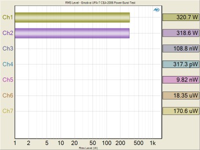

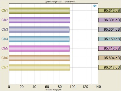

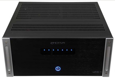

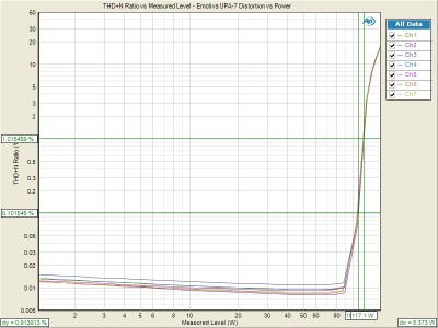

The Emotiva UPA-7 in my mind is an embarrassment - not to itself, mind you, but to the industry. What I mean by this bold statement is, it's built too robustly, measures too pristinely and performs too well for a seven channel amplifier selling for even twice its price. Whether you're looking for a new multi-channel amplifier to update your system or to cure the common receiver with a power boost, the UPA-7 will do so exceedingly well in all but the largest most power hungry installations. In the meantime, you can rest assured that dollar for dollar, pound for pound, a better multi-channel amplifier does NOT exist on the market. This is a safe purchase and a highly recommended one!
