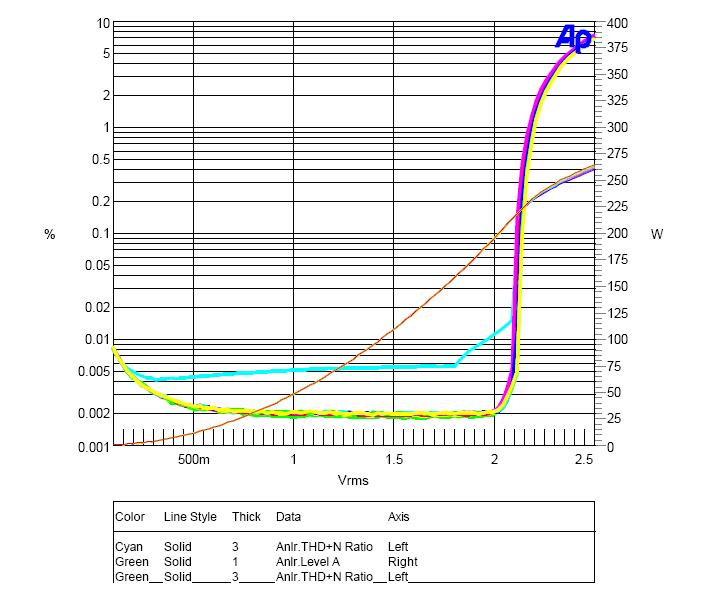

As you can see, I measured the RPA-1 to deliver about 210wpc into 8-ohms and 320 watts into 4-ohms at 0.1% THD + N using my APC S-15 and SBATT to ensure the line stayed at 120V +- 2V.    Keep in mind most review publications test at clipping and don’t do continuous power measurements so our power numbers are usually a lot more conservative than what you typically find from other reviewers. This amp hit its power rating of 200wpc into 8 ohms. Their 350wpc rating isn’t specified at any particular distortion level, but rest assured it can do it at 1& THD + N.
For more info, see: The All Channels Driven (ACD) Test

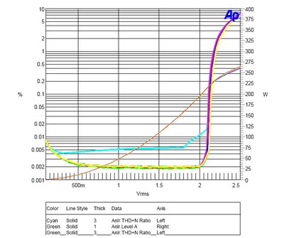

I asked Emotiva to furnish their power measurements vs. distortion to see if their ratings jived with my findings and they did.
Emotiva Power Measurements
Figure 1. RPA Power vs. Distortion
As you can see, the true continuous power rating of this amplifier (Audioholics style at least) is in excess of 200 wpc into 8-ohms.

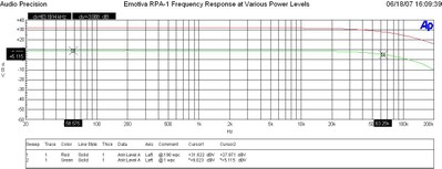

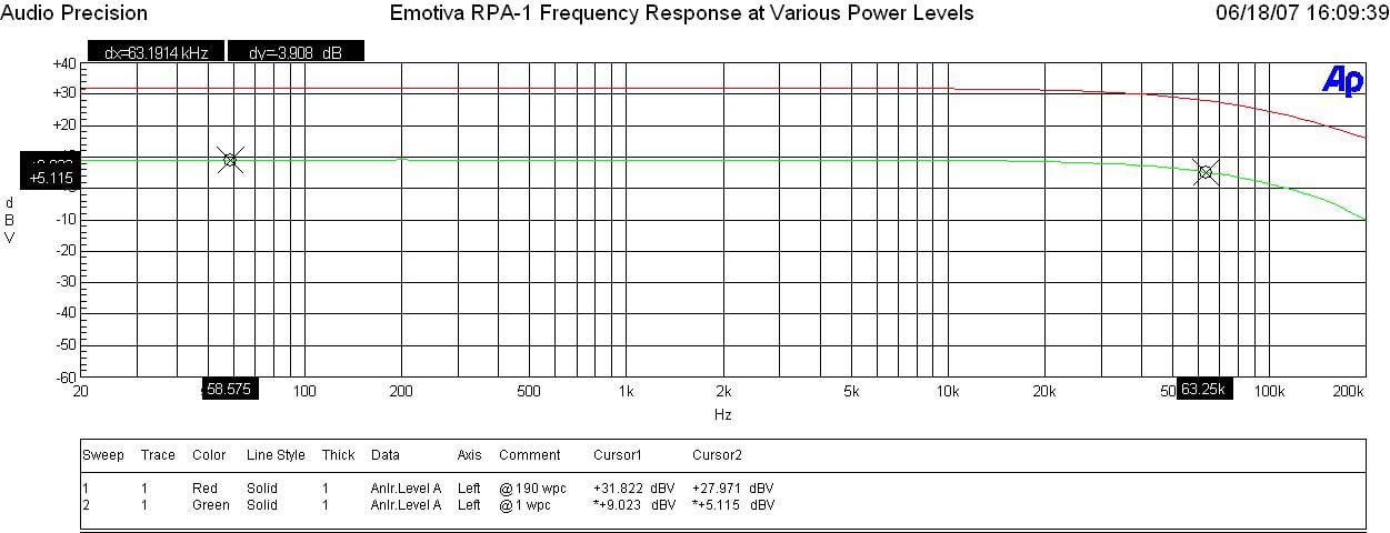

The frequency response was smooth and extended to a -3dB point of 65KHz which is more than enough bandwidth, but a bit puzzling since all of the other Emotiva amps we reviewed had about double the bandwidth. In any event, bandwidth uniformity was excellent at low or high power indicating that this roll off was intentional to ensure the best SNR performance.

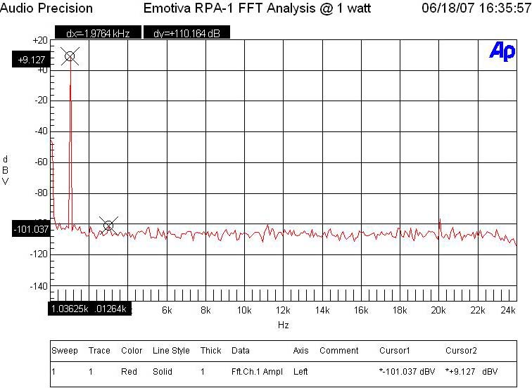

Figure 3.  FFT Distortion Analysis at One Watt
At 1 watt, the RPA-1 FFT distortion test resulted in nearly immeasurable harmonics, a scenario I rarely run into. This amp is super clean at low power which in my book is one of the most important virtues of quality amplification for a controlled listening space concerned with high fidelity playback.
Figure 4.  FFT Distortion Analysis at Full Power

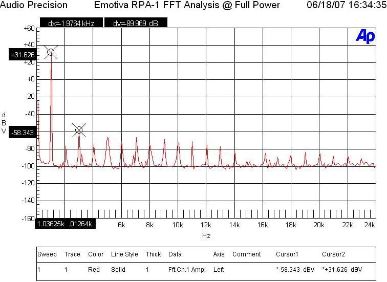

At near full rated power (200wpc) into 8-ohms, the RPA-1 exhibited impressively low distortion (31.6+58.3)dBv = 89.9dBv or 100*alog^-1(-89.9/20) = 0.003%. This figure is even lower than what I measured on the MPS-1 (.008%) under similar load conditions. I suspect the removal of the soft clipping circuit has paid dividends in this regard (lower noise floor, lower distortion).
As many amps approach their full power rating, their power supplies tend to run out of gas and show large harmonic nasties of the fundamental test tone. The RPA-1 maintained its composure commendably demonstrating perhaps why it also sounded so good.

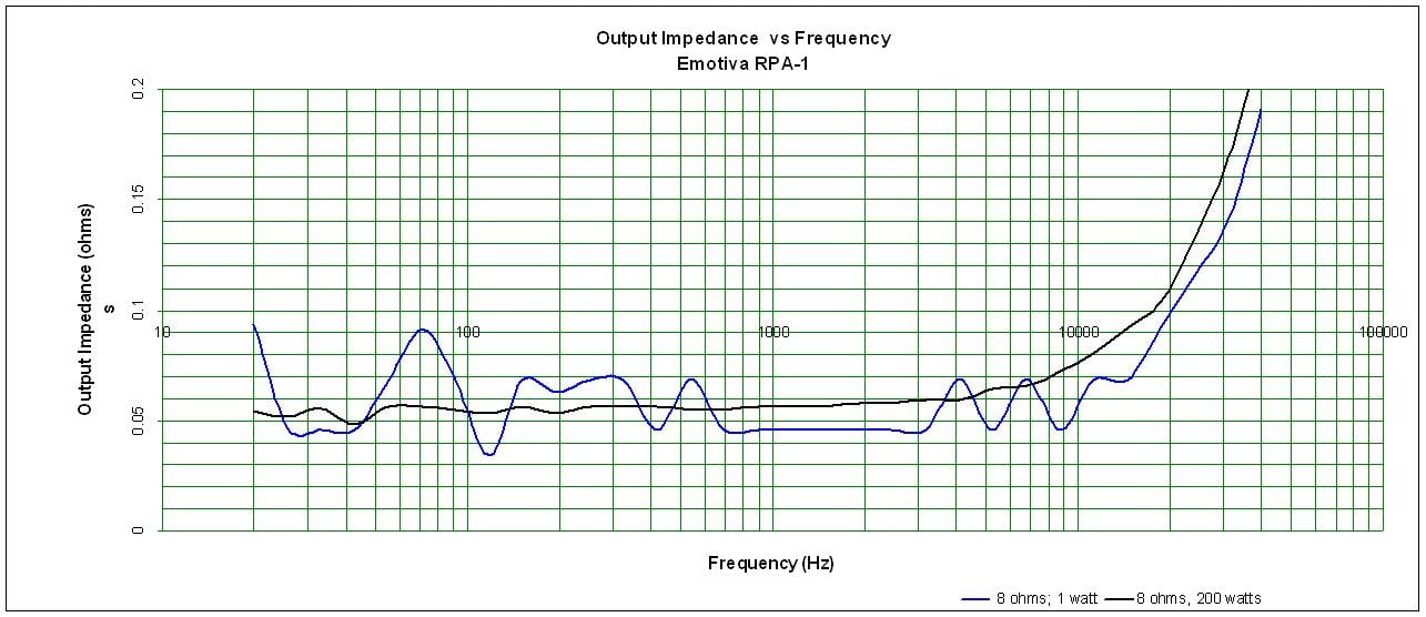

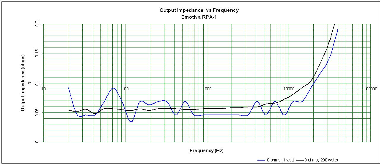

Figure 5.  Amplifier Output Impedance vs Frequency
Amplifier output impedance when the RPA-1 was driving an 8-ohm load at 1 watt and full rated power 200wpc was well below 100 mohm for the entire audio bandwidth with a gradual rise above 20kHz. We like to see amplifier maintain 150 mohm output impedance or less so that it will sound consistently good for a larger variety of speaker and cable loads with rather complex impedance profiles. This is a very good measurement and one of the primary design attributes that will ensure this amplifier will sound consistently good on a wide variety of speakers.

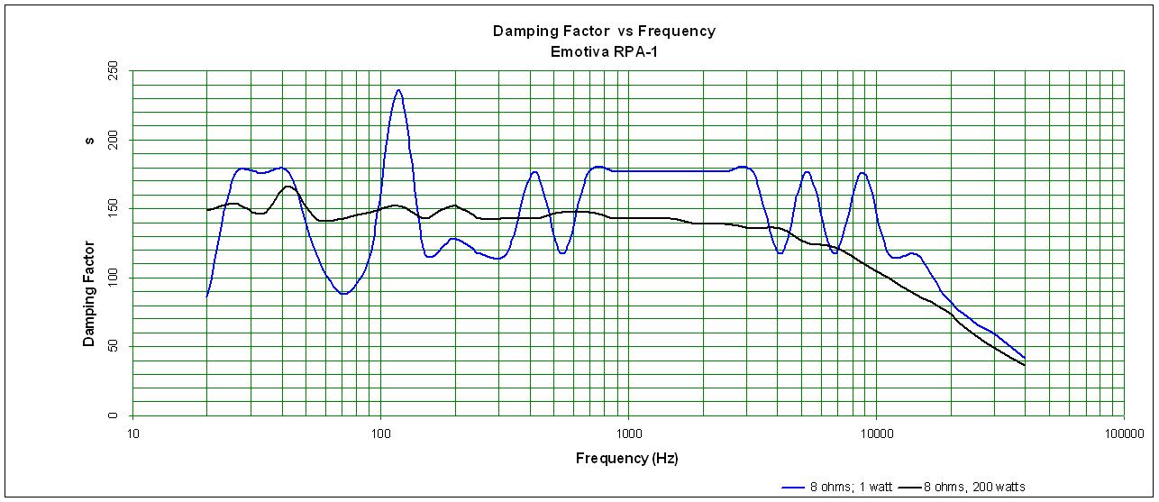

Figure 6.  Amplifier Damping Factor vs Frequency
Again the RPA-1 did NOT disappoint. An amplifier with a low output impedance will also maintain excellent damping characteristics since these are related metrics. The RPA-1 maintained a damping factor of around > 150 for 8 ohm loads. This exceeded our benchmark criteria with flying colors.
