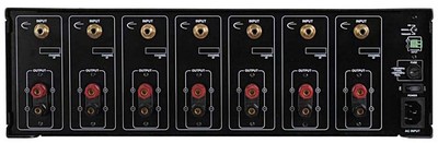

RCA inputs

IEC power inlet, 120/230 VAC user configurable
