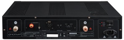

The back of the XPA-1L has exactly what you'd expect from a high quality amplifier from Emotiva. There is a gold-plated RCA unbalanced input and a XLR balanced input. The speaker terminals are, unfortunately, located quite far away from each other (a pet peeve which may be troublesome for some users with custom cables) but feature gold-plated 5-way binding posts. The amp will accept 115 VAC or 230 VAC which is automatically detected and switched. For ease of use, Emotiva has included 12 volt trigger input and output.

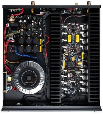

Inside we see the very interesting layout of the XPA-1L. Emotiva has included 90,000 uF of capacitance and a 450 VA heavy duty toroidal transformer. The amplifier is fully balanced, fully discrete, and features a high current, short signal path, Quad Differential design. The large internal heat sinks are to protect from overheating during Class A operation.
XPA-1L_top
You can set the Emotiva XPA-1L to Class A/B or Class A operation via a switch on the front panel. When in Class A mode, the XPA-1L delivers 35 high bias watts into 8 ohms. Emotiva hasn't provided a 4 ohm rating, but we are quite confident it doesn't exactly double down in power driving a 4 ohm load when operating in this mode else it would consume way too much power. If you exceed the 35 watt threshold, the XPA-1L transitions into Class A/B, allowing it to deliver its full rated power. There is no indication from Emotiva that the XPA-1L lets you know when this happens but this will occur at much louder than background listening levels where purists will probably find acceptable. Green audiophiles wanting to save the planet and cut down on their electric bill will probably opt to run the XPA-1L in Class A/B mode all of the time.
