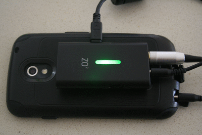

The last thing I'll mention is about the user interface. The color-coded display is so hard to read as to be pointless. If the colors between the different levels were more distinct, or if there was some sort of audible or tactile indication that you had switched a level, it may have been useful. As it is, 32 gradations of color between green, yellow, orange, and red are impossible to read. I know that for some headphones I liked the bass boost completely off, with others I liked it around yellowish. Yellowish is not a setting. Since I'm not going to sit there and count my button presses, I don't know exactly what setting I liked for any given set of cans. Even if I did count the number of times I hit the button, without any user feedback, it is impossible to know that each press was registered once, twice, or at all.
zo2_colors
I went through all the colors one click at a time and could more easily hear the difference than I could see it from the color. If you are okay with this sort of muddiness of control, don't worry about it. In actual practice, "yellowish" was good enough. But as a high-end device (they like to talk about how people pair their ZO2 with $300+ pairs of headphones), I'd think a little more feedback would be in order. With the color coding of the volume on the Line mode going between blue and purple, I can only imagine how confusing that would be.
