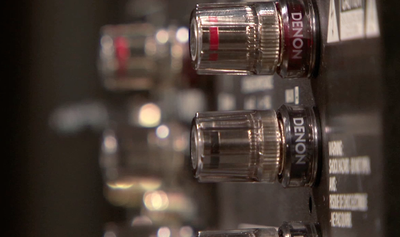

One absent feature is a line of power outlets on the back that can act to switch on devices when the PMA-A100 is turned on. As more and more audiophiles are turning to power conditioners, that's not entirely surprising. For speaker connections, the A100 has 4-pairs of high-end 5-way binding posts that can be used for bi-wiring a pair of speakers if desired. We've found bi-wiring to be mostly a waste of time, but some people have the cables lying around and enjoy it, so there you go - it's ready for you.

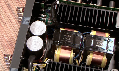

As for power, the A100 puts out 80 watts per channel into 8-ohms at .07% THD. Dynamic power is rated up to 160 watts into 4-ohms, but this is likely continuous given what we're seeing in the amp. We bench-tested this amp below and so check out how it performs when you halve the impedance. And the construction of the amp is beautiful inside as well as out. The power layout is symmetrical with dual transformers, giant 71V 12000 microfarad capacitors, and big heatsinks. It's a work of art.

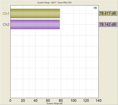

Signal to Noise Ratio
Denon PMA-A100 SNR @ 1 watt (unweighted)
The Denon PMA-A100 measured 78dB SNR at 1 watt with 100mV input signal. This is a good measurement but not as stellar as we've seen on other high quality gear. At rated power (80 watts), the SNR was 98dB.

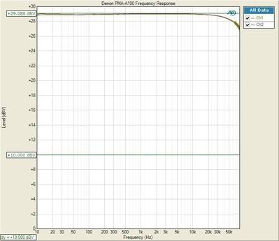

Frequency Response
Denon PMA-A100 Frequency Response
The Denon PMA-A100 exhibited ruler flat frequency response for the full audio bandwidth even when driven at 100wpc into 8 ohms which is above its 80 watt power rating. The -3dB point is around 80kHz which is the limit of the Audio Precision test equipment.

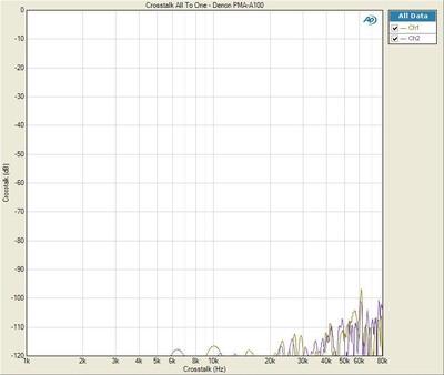

Crosstalk
PMA-A100 All-to-One Crosstalk at Full Rated Power
I measured each idle channel one at a time while the other acted as the disturber to determine the worst case channel to channel crosstalk. The PMA-A100 produced some of the lowest channel to channel crosstalk measurements I've ever taken on an amplifier! This is no surprise given the immense real estate this amplifier has for only two channels. Whether I measured at 1 watt or full rated power, channel to channel crosstalk was better than 100dB for the entire audio bandwidth. Note how at even 80kHz this amplifier produced superb results.
