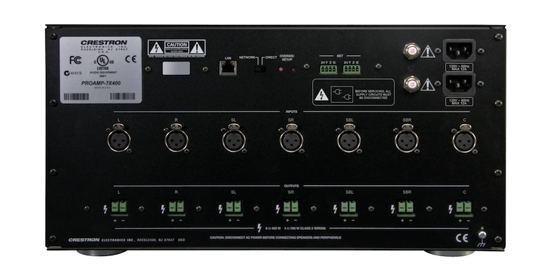

proamp_rear
Glancing at the back you'll notice two power cord ports as the PROAMP 7X400 needs a lot of juice. This is not unheard of and a solution we've seen on other amps in the past. There are balanced inputs but no provision for unbalanced RCA inputs, a curious omission. While it is clear the the Crestron PROAMP 7X400 is designed to work with the PSPHD, leaving off the unbalanced inputs seems a bit shortsighted. It isn't like only PSPHD customers are going to end up with this amp. Eventually one will show up on one of the auction websites.
The other oddity is the omission of traditional five-way binding posts. Instead, Crestron included only the little green screw type connections which, while familiar to industry professionals and custom installers, are all but foreign to audiophiles. It seems like Crestron could have included both traditional binding posts and unbalanced inputs for consumers as well as the balanced and CI binding posts for installers.
Editor's Note: The intent of the design seems to be squarely for the custom install market, so we're not surprised at the lack of binding posts here
There is a LAN connection on the back for control via the PSPHD. Using a simple Ethernet connection, the PSPHD processor and PROAMP amplifier automatically pair, enabling seamless control and monitoring of the amplifier through the PSPHD front panel. If you remember from our coverage of the PSPHD, the front panel display can be modified to display real-time VU meters or spectrum analyzers. Plus you can actually confirm the specific fault condition, check the real internal temperature, and even monitor the output level of each amp channel on the face of the PSPHD. Pairing the two components also streamlines remote control and monitoring through a Crestron control system, providing programmers with a unified device interface for all functions.
But even without a PSPHD (and another reason Crestron could have included traditional binding post and RCA inputs), the PROAMP-7X400 can be integrated into a Crestron install. Using Cresnet and high-speed Ethernet you can directly control and monitor the PROAMP via a Crestron control system. You can control amplifier power, mute individual channels, monitor temperature and signal status, and receive fault alerts, all from a Crestron touchpanel, computer or mobile device. Signals from the amplifier may also be utilized to enable custom automation, such as reducing audio levels when clipping is sensed, or regulating climate control in the equipment room in response to amp temperature.
The one thing we couldn't find about the Crestron PROAMP-7X400 "PROCISE" amplifier was the price. With processor coming in a $11k and a lower powered amp also in the line-up, we're betting it'll be close to the processor price. While there are some curious omissions on the back panel by way of traditional inputs and outputs, there is a lot of smart technology under the hood for monitoring and controlling the amp. Much of it you can access even if you don't pony up for the Crestron PSPHD "PROCISE" processor. You'll either have to learn Crestron protocols or have an installer set it up for you but it is there. We respect that Crestron came out with not only an amp companion for their new processor but also reasons for you to pair them together. We just wish they'd made it a bit more user friendly for those that don't want to buy their processor.
