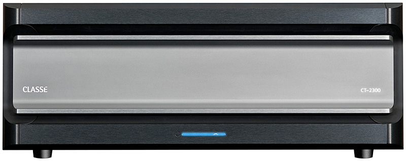

2300-frontMy time with the Classe CT-2300 two-channel amplifier has been a pure delight. Its pristine sonic virtues, ability to drive even the most challenging of speaker loads beyond reference levels, and its stellar bench tests results all equate to a trifecta amplifier few at any price could surpass. The fact that it runs cool even when driven hard makes it an installers delight that they can rackmount a few of these virtually right on top of each other without worrying about heat dissipation issues.
About the only thing I can diss the CT-2300 on is its rather generic rubber feet. OK I’ll admit, I have a foot fetish and expect my audio components to have nice feet, especially at this price. However, Classe does offer an optional foot upgrade for those not as concerned with taking up a bit more valuable vertical rack space or wanting to place this amplifier as a stand alone piece on a shelf or the floor. With the CT-2300 powering your speakers, you will soon forget about the ho-hum rubber feet while entering a sonic landscape not achievable with lesser designed amplifiers. The only thing I urge potential buyers on before considering the Classe CT-2300 for your next amplifier purchase is to make sure your speakers are up to the task. Your system is only as good as the weakest link and I can assure you the CT-2300 will not be the kink in the chain. After two months of dining on the CT-2300, I can say with total confidence that my appetite is fully satisfied. Highly recommended!
