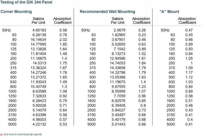

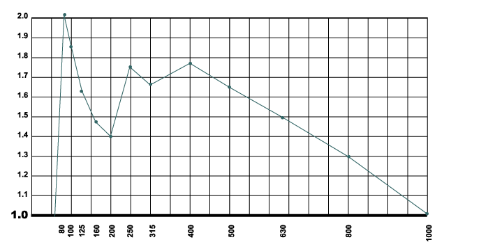

Absorption Report
GIK Acoustical panels have been tested and certified by the Riverbank Acoustical Laboratories .
GIK Acoustic Panels submitted to two standard acoustic test methods: ASTM "A" and "J" testing. For "A" testing, the acoustic panels are placed all together flat against a surface and tested. "A" testing is the standardized testing method for the manufacturing industry. "J" testing simulates the recommended mounting of the product by the manufacturer. GIK tested two set-ups:
  1. Panels straddled in corners.
  2. Panels spaced off the wall and mounted on stands.
In an acoustic laboratory, absorption of sound is determined by measuring reverb decay time at specific frequencies (Hz). Reverb decay time is the time it takes for a standardized impulse sound to fall to a certain db. During a test, the reverb decay time for each impulse sound is recorded in specific areas of the room and at different heights. The data of the reverberation is calculated into Sabins. Based on the Sabins' numbers, the absorption coefficients can be calculated. The higher a number at a given frequency, the more sound is absorbed.
