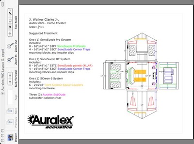

Many people think that the secret to a great home theater is great gear. And when you ask them what that gear consists of, it will usually be a display, speakers, components, and cables. But the ingredient that can often make or break a home theater is the room itself. My room is an excellent case in point, which is why I chose to bring in the good folks at Auralex.

Just remember that there are a lot of other more effective materials than foam. Also, doing ANY material in just 1" and 2" will leave the bottom end untreated. The idea is to use the proper amount (more is not always better) and to balance the absorbtion across the frequency spectrum.

Room treatments are the best way to spend your money. Speakers & electronics are simply prisoners in their surrounding room. Unless your room is properly treated, you have no clue as to how good your present rig can sound. Start doing some research. I find it comical that folks will drop thousands on gear & speakers & never bother to factor in the room as the biggest contributer to sound quality.

I was very suspicious of room treatments until I spent the money on 12 2' x 4' 2 inches thick treatments and placed them at the first reflection points as well as the 2nd and it made a huge difference in sound quality. I then used my Denon 5805ci's auto set up and as Emeril would say "BAM". Huge difference.
