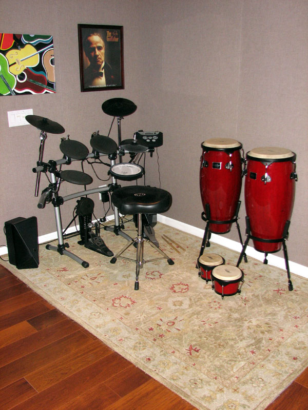

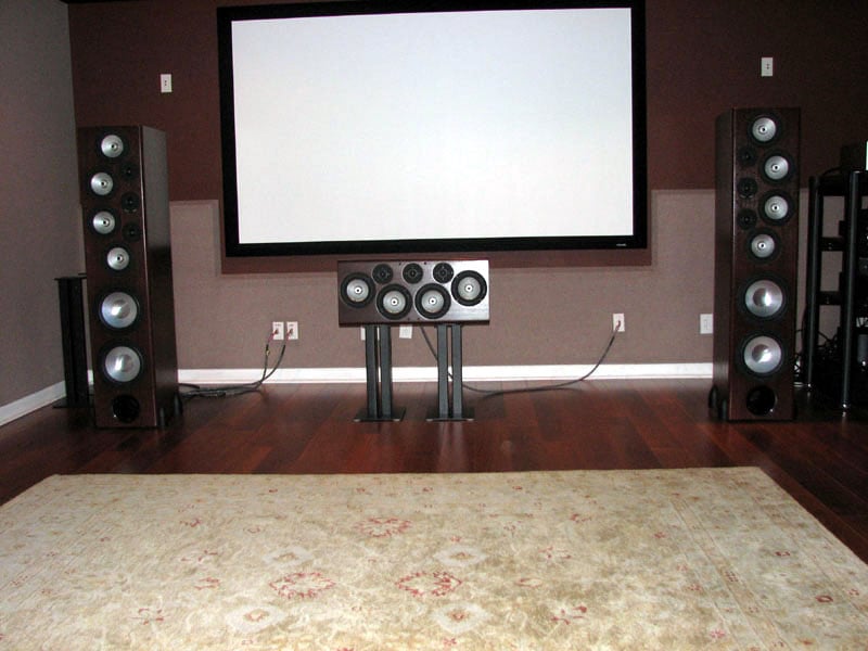

Our heavy throw rugs and pads showed up, one for the first reflection point relative to the front speakers, and the other to place under our electric drum kit and bongos towards the right side of the room.  A throw rug was necessary for the drum area because the upper midbass region sounded boomy and hollow and also because the foot pedals and drum kit weren’t secure on the wood flooring.  The throw rug overlayed on the wood flooring simply looks stunning in our opinion.  We felt it really jazzed up the rooms appearance almost making it feel like a studio environment.
Front RoomTo our relief, the throw rug greatly helped the drum area.  The resultant sound character was similar to what it was with the carpeted flooring, only it was now a bit more lively (which is what we were after.)  We were really quite amazed that the flooring made such an impact at upper bass frequencies.
The 8’ x 10’ throw rug we placed at the first reflection point for the home theater area cleaned things up significantly.  Speech intelligibility improved dramatically and the sound started coming into focus.  Stereo imaging was greatly improved and the soundstage emanating from the front speakers felt larger than it had with the carpeted flooring.  We found that moving the left mid-wall sub about 2 feet closer to the font wall helped tighten up the bass. This was confirmed both audibly and with measurements. The overall sound quality of the room just sounded livelier overall, though we still did notice some degradation of sound quality and listening fatigue at very high playback levels - something not experienced with the carpeted flooring.

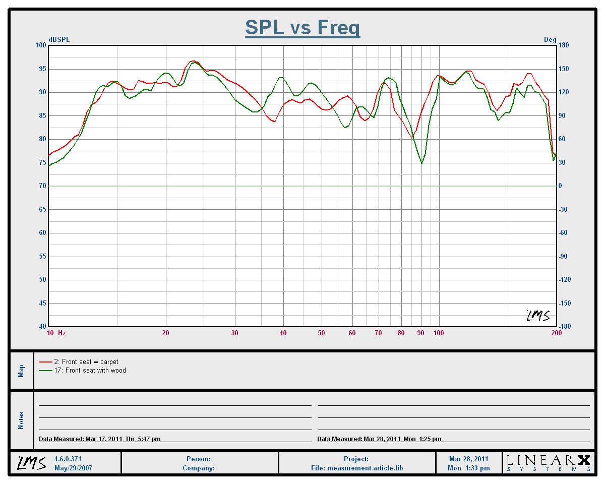

Floor Compare

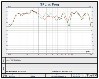

In-room Low End Frequency Response; red- wood flooring green – wood flooring
For comparative purposes I pulled a low frequency measurement at the front row location with the carpeted flooring (red) and wood flooring (green) using as close to identical mic positions as possible.   The measurements tracked each other fairly closely with perhaps a bit more output in the 30-50Hz range with the wood floors.  It is possible part of the boominess I was hearing was related to this bump that wasn’t present with the carpeted flooring.  Repositioning the left midwall sub and EQing the overall response of all 4 subs helped dial back in our optimal frequency response.

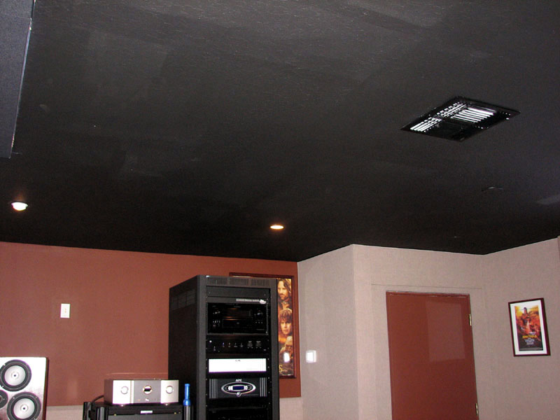

Bare CeilingWalking around the room and using the somewhat crude, but useful, 'clapping hands' tests, we found a huge area towards the right side that suffered excessive flutter echo issues due to the bare hard parallel surfaces of the ceiling and hardwood flooring.  This is the “L” shape area of the room to the "starboard" side of the right front speaker.  To more accurately assess its impact, we had one person standing by the right front speaker clapping their hands, while I sat at the primary listening area listening for unwanted flutter echo.  The results were far less dramatic than clapping directly under the origin point at the side of the room, but it was still audible nonetheless.  Considering that we often listen to music at much higher playback levels than we could achieve by clapping our hands, it was logical to presume this imbalance was an offending contributor to premature listening fatigue and the blurring of the soundstage at high playback levels.
Interestingly enough, when standing directly in front of the right and left front speakers, we could hear distinct differences between the corresponding flutter echo while clapping our hands at each point.  This was also observed at the listening area too.  There was obviously an imbalance between the front left and right speakers that wasn’t present (or noticeable) when carpeted flooring was installed.  Asymmetry is not a good thing between a stereo pair of speakers, so it was becoming clear to us that this problematic area of the ceiling needed to be treated with absorption.

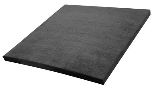

Most absorption tiles are not offered in anything other than white, so I was quite pleased to discover the Auralex SonoLite panels which also come in either black or tan.  I chose black.  SonoLite is a 2’ x 2’ x 1” fabric wrapped absorption panel with a Studiofoam Pro core which Auralex claims is a cost effective alternative to fiberglass fabric-covered panels.

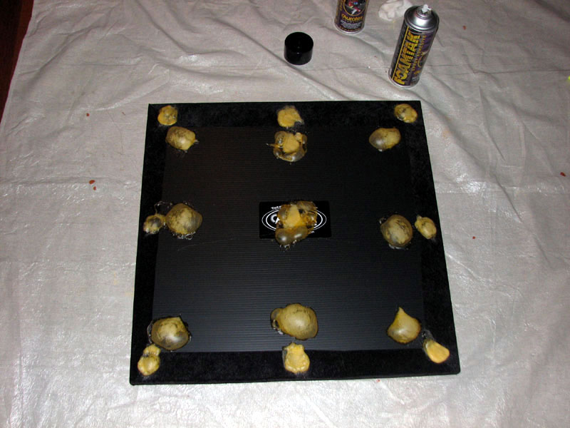

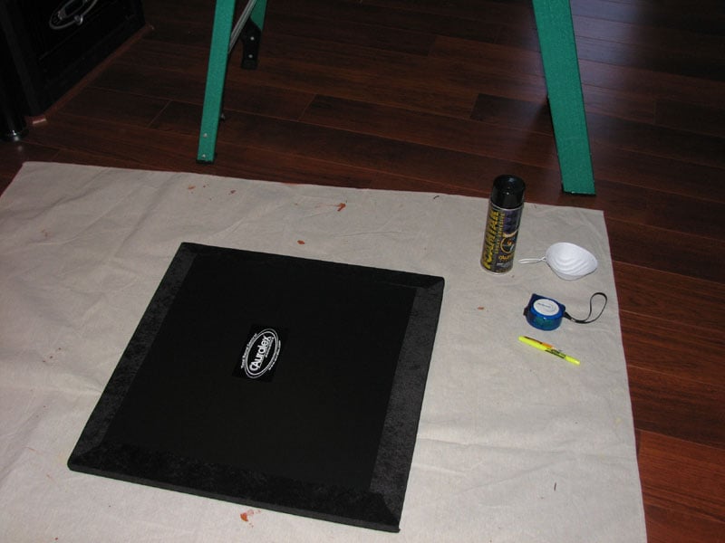

The area we wanted to treat was roughly 10’ x 8’ and we estimated about 10-12 panels would do the job nicely.  The SonoLite panels can be installed by using either adhesive spray glue or Velco industrial strength double-stick tape for a less permanent mounting solution.  I chose to use the glue option but in hindsight, I’d strongly advise using adhesive tape instead.  Glue smells bad while its wet, it’s messy and it takes a lot of time and patience to get an object to stick against the ceiling while fighting against the force of gravity. It’s also rather difficult to remove requiring a complete repainting of the ceiling if you later decide to remove the panels.  Make sure you really want the panels in the location you chose before glueing them down!
materials   Panel Glued
Auralex SonoLite & accessory equipment needed for installation(left pic)  & glued panel (right pic)
The items you will need for installation are as follows:
  • Step ladder
  • Measuring tape
  • Marker
  • Spray Adhesive or Velco tape
  • Large plastic sheet or old blanket (if using glue)
  • Mask (if using glue)
  • Gloves (if using glue)
SonoLite installedWe found the Auralex adhesive glue is about the best spray glue I’ve ever used.  It’s a bit denser than the stuff you can buy at your local hardware store.  The best way to get the panels to stick on the ceiling while not using massive amounts of glue is to spray little circles in all of the corners and sides as well as the center area.  I initially used crisscross patterns but found it used too much glue and it didn’t work as well.  Now here comes the hard part: getting these panels to adhere to the ceiling.  Make sure you have your gloves on when handling the panels.  I found that pressing the panel against the ceiling, then removing it for a second and reapplying really helped to get the panels to stick.  You also will need to apply constant pressure against the panel while also lightly patting it all around.  I used my head at the center while I patted the panel.  Be careful not to press too hard or else you risk compressing the panel which will limit its effectiveness.  Each panel took a good 5 minutes or so to stick to the ceiling, so patience is needed.  I actually found that I had to go back 20-30 minutes later to each panel and press them against the ceiling to get them to permanently stick.  This whole process was murder on my neck and back but a true Audioholic is willing to endure some pain for the betterment of sound quality.  A smart Audioholic however will learn from my mistake and take my advice to use Velcro tape adhesive instead of glue.  Because we used glue, we found it difficult to precisely place the panels where I wanted them so the installation wasn’t perfectly straight, but good enough in a darkly lit room.  We wound up installing 11 of the 12 supplied panels which covered the area nicely.  The extra panel was stowed away for future use or replacement if needed.

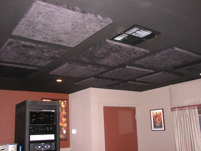

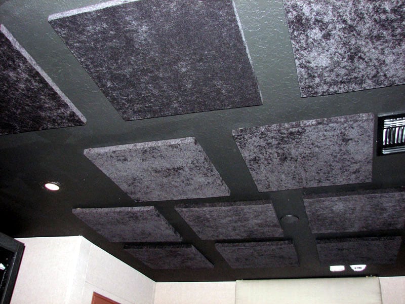

Flutter echo directly under the SonoLite treated area simply vanished.  We were a bit concerned given the ample spacing between panels, but it all seemed to work out fine.  We repeated the clap tests at the listening area for the front left and right speaker locations and found the nasty echo sounds gone.  There was definitely more symmetry between the speaker locations now which is exactly what we were hoping for.

Auralex proved their new SonoLite panels offers the performance and aesthetics you need when fine tuning the acoustics of your theater room.  SonoLite is easy to install and it addresses the issues of excessive flutter echo which may arise in a theater room where there is a great deal of parallel hard surface areas (wood floor and drywall ceiling).  Best of all, SonoLite is a tool-less solution which doesn’t require any fancy tucking of fabric into pre-installed mounting tracks.  Simply apply an adhesive and place them in the problem areas and you’re done.  If you find your home theater system to be fatiguing over extended listening sessions, consider evaluating and addressing your room acoustics issues before spending hard earned dollars on upgrading equipment (or even worse, cables).  For less money than a cable tweak, Auralex Sonolite ($30 per panel) provides a real solution to potentially transpose your listening experience from good to excellent.  Highly recommended.
