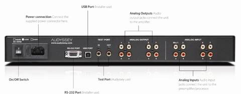

Analogue input: 8 channels, unbalanced
Analogue input reference level: Industry standard for controller outputs – 150mVrms
Room correction: MultEQ XT filter for each channel applied at sub/sat splice
SNR: 108dBA
Connections: RS-232 port, USB 2.0, 4 pairs analogue RCA (unbalanced) outputs, 4 pairs analogue RCA (unbalanced) inputs, test port (Audyssey use only)
