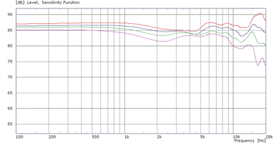

Mordaunt-Short Performance 6 1 Meter Frequency Plots (smoothed)
Red trace - on axis
Blue Trace - 15 degrees off axis
Green trace - 30 degrees off axis
Purple trace - 45 degrees off axis
The tweeter level appears to be set a bit too high as indicated by the +3dB bump at 15kHz (on axis measurement). Though in our extensive listening tests, we never found this to be fatiguing or overly colored sounding. The Performance 6 speakers measured best at 15 degrees off axis, maintaining a ±2dB window from 100Hz to 20kHz. This partly explains why Clint found they sounded best with only a modest toe in. The downward trend in the 2-5kHz region, coupled with the slightly hot top end may also explain why Clint found the upper midrange to be a bit recessed sounding compared to his RBH Sound reference speakers. In any event, the family of on/off axis curves indicate excellent polar response and a very wide listening window which is what Clint experienced when putting these high performance speakers though their paces.
