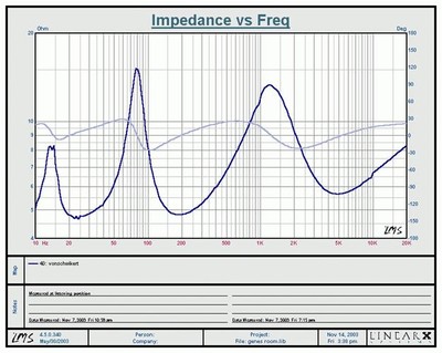

Performance Curves of VR-1
Dark Blue - Impedance Curve: Min impedance is about 4.75 ohms between 150-200 Hz, with a peak of 15 ohms at 70 Hz (around the bass limits of the speaker). Due to the relatively small port and low tuning frequency of around 30 HZ , there is really no usable/audible contribution from the port. Instead, the port acts to limit driver excursion at very low frequencies and increase dynamic range of the speaker. The rising impedance of the speaker starting at around 7kHz exhibits inductive loading.
Light Blue - Electrical Phase Plot: The VR-1 bookshelf speakers have good phase response as indicated by ± 30 degree window it maintains within the entire audio spectrum above 70 Hz. In addition the moderately high sensitivity (89dB SPL @1 watt/meter) and lowest impedance dip of 4.75 ohms indicates pretty much any decent solid state amp should be able to drive these speakers without incident. However, we suspect an amplifier with the lowest possible output impedance would be beneficial due to the reactive nature of the impedance curve to minimize any possible frequency variations.

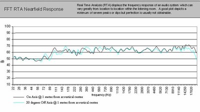

VR-1 Near Field Frequency Response
The VR-1 bookshelf's (or Reference Studio Monitors as the Manufacturer classifies them) were placed on 30" stands at least 6 feet away from all walls in a well damped room with carpeted floors and flat ceilings. The on axis response (black) indicated a slight emphasis on high frequencies above 10 kHz. The 30 degree off axis response (cyan) helped to smooth the overall response of the speaker indicating that this speaker may perform better with minimal toe in, especially in lively rooms. |
