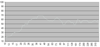

Figure 3. Listening Position Low Frequency Response (1/12 th Octave FFT Analysis)
To get a better look at the bass response of the Intimus loudspeaker system, and how it integrated into my listening room, I ran a 1/12th octave low frequency FFT analysis focusing from 20Hz to about 300Hz. As you can see, room gain was partly responsible for the impressive 3dB point of 27Hz. The manufacturer states a low frequency response of 30Hz and these speakers certainly delivered that and then some without any fuss.

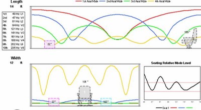

Figure 4. Analyzing Listening Room Modes
It is interesting to note that when I ran my room dimensions into the Quest Room Mode calculator factoring in loudspeaker position (treating each Intimus Tower as a subwoofer) and my listening position, we see fairly similar dips at 47Hz and 94Hz with the bumps around 40Hz. The nulls were being attributed to the listening position located at the 4th axial / 2nd width room mode, while the bump at 40Hz seemed to be a result of the 1st , 2nd and 3rd axial modes (1st length, 1st width, 2nd length modes, respectively). While my room certainly isn't an ideal rectangle as this room calculator assumes, it still portrays a fairly accurate representation of what is going on in the listening position measurements for bass frequencies in figures 2 and 3.
