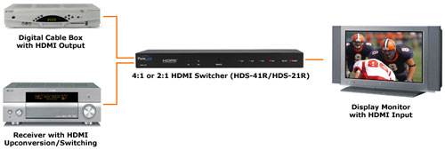

Because of this issue with cable boxes, some owners of new HDMI-switching and upconverting receivers cannot take HDMI input from their cable boxes and output the resulting signal to their displays. If you don't want to lose the convenience of HDMI upconversion for your other sources and still want to route both signals to your display, an HDMI switcher is a viable solution. Here is what the system looks like:
Simply route the cable box directly into one input of the HDS-41R and send the receiver's HDMI output into another input (you can use a 2x1 switcher like the HDS-21R if you want to save some money and do not need the additional 2 inputs). Send the HDMI output of the switcher to your display device. Now program your remote control to switch the PureLink HDMI switcher to the one input when watching cable, and the other input for everything else (the output of the AV receiver). I have done this in Reference System 2 and it works flawlessly. In my opinion this is a worthwhile stop-gap considering it could take a long time for the cable companies to get on the ball and push out a firmware solution. For more on this issue, please visit our dedicated forum thread that deals with this topic.
