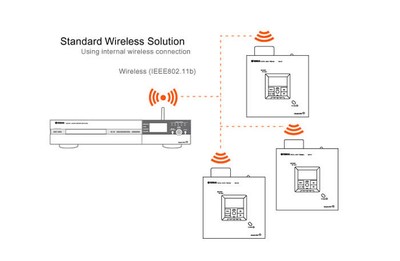

Figure 1: Standard Wireless Solution

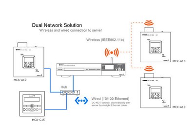

Figure 2: Dual Network Solution
Figure 1 is the configuration to use with wireless clients (MCX-A10). You then connect your loudspeakers (recommended > 89dB efficient; 8 ohm) to the client or use Yamaha ones to aesthetically match the system’ look.
Figure 2 represents both a wireless configuration from Figure 1 and a simultaneous wired system using a hub to connect multiple wired clients.
Note: If running just one wired client, you can connect via an Ethernet cross-over cable instead of a hub.

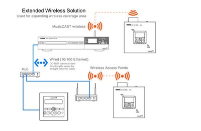

Figure 3: Extended Wireless Solution

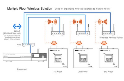

Figure 4: Multiple Floor Wireless Solution
Figure 3 represents an extended wireless solution using a wireless hub to extend the reach of the signal to serve a far away remote client at greater distance from the MCX-2000 server.
Figure 4 expands upon Figure 3 with all three remote clients being at greater distances from the MCX-2000 server, perhaps on different floors as the diagram illustrates.

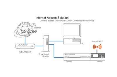

Figure 5: Internet Access Solution
Figure 5 illustrates how to connect your MCX-2000 server to the Internet to take advantage of the Gracenote CDDB CD recognition service.
