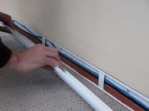

Basically, all you need to do to install Wire Tracks is replace the existing baseboard molding with the
Wire Tracks molding. The wire tracks moldings are available in 5 ft or 8 ft sections.
Comprehensive instructions are included with the kit that explains how to lay out rooms of various sizes and shapes. It even guides you through the set up of the miter saw if you need it. Installing the Wire Tracks behind the existing molding is a little more time consuming than simply replacing the existing molding. This will require you to carefully remove the existing baseboard molding and do some minor demolition of the wall surface.
The use of an automotive dent puller as shown below can be helpful for removing existing baseboards. Simply drill a pilot hole in the baseboard, screw in the dent puller and carefully tap the baseboard from the wall. If you have caulking applied to the top of your baseboard it may be helpful to score it with a razor blade before removal. Take your time as to not break the existing baseboard if you plan on reusing it. The Wire Tracks channel can also be installed around a doorframe.

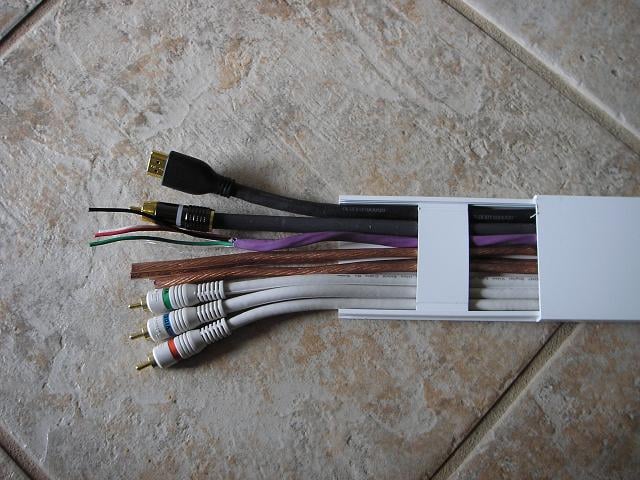

The channel is
large enough to accommodate many wires. I was able to place a set of component video cables, one pair of
twelve gauge speaker wire, one run of 16-4 CL#3 in wall speaker wire, one Impact Acoustics subwoofer
cable and one HDMI cable in the channel and still snap the cover on without incident. The cables are
neatly kept in place with the use of plastic straps that snap into the channel.

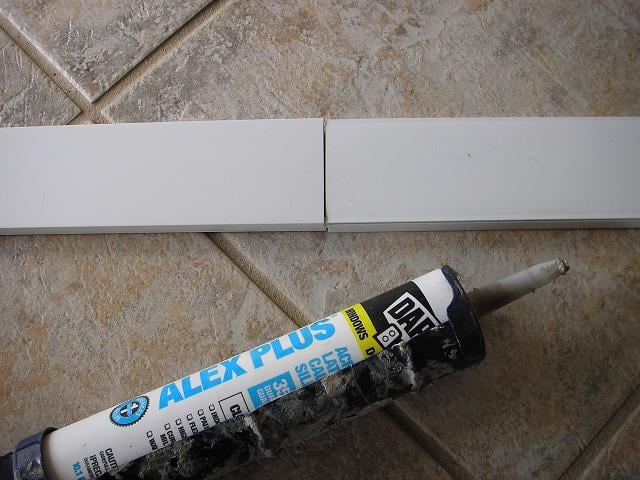

The most time consuming part of the installation process is laying out the room and making corner cuts. Bending the wires around outside or inside corners can be a little tricky, but with some patience it can be accomplished. The use of a level is highly recommended to keep the runs of track straight. It is also advised that you check the factory end cuts to make sure they are square. Several times I found the cuts to be slightly angled which has the potential of making it difficult to create a seamless run. There are no covers provided for where the Wire Track runs come together but paintable silicone can be used if you have a small gap at the butt joint.
