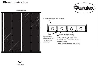

Auralex prepared a basic design sketch for me to follow and it was up to me now to determine how big I needed to make this riser.
The above diagram shows the basic structural layout and design. Notice the front ports which I actually doubled up on (more on this later) and the Auralex U-boats which are used to mechanically isolate the riser from the rest of the flooring.

Make the volume as large as possible. If there is a choice between 2x6 or 2x8 joists, go with the 2x8s.
Make the front openings as large as possible, while still retaining the structural integrity of the riser. In a riser constructed with 2x8s, for example, make the holes between each pair of joists (preferable - between every other pair at a minimum) as wide and as tall as possible. Shape is not really a big deal so much as size.
The U-Boats shown in the illustration are critical. These will not only "float" the riser, but even the addition of the small airspace under the joists which will decouple the riser from the main floor and improve bass definition.
Select dense top materials for added rigidity and minimization of mechanical noise during resonance. MDF is much better than plywood in this regard.
Fill each cavity with roughly 75% mineral fiber. The more you fill, the less tactile response you will feel, the less you fill, the more resonance will be perceived. I found around 75% to be ideal but certainly some experimenting is open for debate if you have the desire for the trial and error process.

The riser is partitioned into individual cavities via 2 x 8 beams separated 16” on center. Each of the 2 x 8s form quasi internal bulkheads, partitioning the internal volume of the riser into individual, semi sealed chambers. Each chamber is 75% filled with Auralex Mineral Fiber leaving a 25% air gap between fiber material and riser flooring. Each chamber is tuned by its respective pair of 1 1/2” ducts functioning as a Helmholtz resonator. Based on the individual size of the chambers, they act as narrow band absorbers in the lower frequency range (below 30Hz) but aren’t 100% effective at this task since each chamber isn’t completely sealed off from each other. The U-Boats leave about a 1” air gap between chambers. It was necessary to decouple the riser from the floor using the U-boats to increase tactile response. I felt the trade off of better tactile response vs. more effective broadband absorption in the 20-30Hz range was a good compromise especially since I was using multiple subs with active Audyssey equalization to smooth out bass response in all listening seats.
