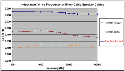

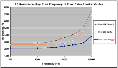

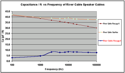

Electrical Characteristics
  • Capacitance: 10 pF/ft
  • DC Resistance: 0.003 ohms/ft
  • Velocity Factor: 0.87
  • Inductance: 300 nHy/ft
