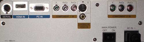

Video Inputs: HDMI-HDCP, component, composite, S-video, and PC/RGB (HD15)

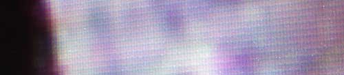

  • ZERO screen door effect from real viewing distances
