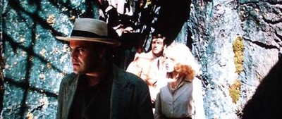

OK, without any further delay I wanted to post the new round of pictures I took using the Helios player and the Westinghouse 1080p display. While taking pictures of flat panel displays with an LCD camera is a bit daunting and undersells the impact of a high resolution display, the results are quite stunning in person:
Chicken Little via DVD at 1080p
King Kong (2005) via DVD at 1080p
The facial and hair detail in The Fifth Element were exceptional
These scenes revealed the poor deinterlacing and lack of 2:3 pulldown of the Helios DVD player
As shown above, this player has a phenomenal ability to reveal detail and texture. The images from The Fifth Element were so good I had to remind myself I was watching a standard definition DVD. The poor deinterlacing ability of this player and lack of 2:3 pulldown is its downfall, however. Much like Rainbow effect in DLP projectors, once you start to see jaggies - you're pretty much ruined.
