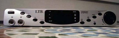

The headphone preamp is intuitive enough to not require thumbing through the manual to figuring out its most basic control settings. You can adjust levels via the front panel buttons on the preamp unit or via the nifty remote control supplied with this system. Unfortunately channel trims are only adjusted in pairs (ie. L/R Front, L/R Surround, Center, Sub). While we're sticklers about this in processors, this shouldn't be too much of an issue considering each ear is equidistant from the speakers in the headphone and there are minimal acoustical differences on either side, assuming you have normal hearing. Huh, what did you say?

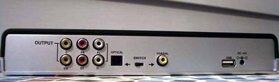

Surprisingly, the LTB AC3Amp5.1 sports 5.1 channel analogue outputs (a feature most sub $400 A/V receivers lack) for people wanting to use this as a preamp to power external amplified speakers or dedicated external power amplifiers. It also provides for selectable toslink or COAX digital S/PDIF inputs and USB connectivity to a PC.

The LTB AC3Amp5.1 supplied remote control although small and rather mundane, gets the job done nicely. I was particularly pleased to see the circular arrangement of channel trim adjustments much like a traditional 5.1 speaker layout. The remote even allows for toggling between headphone pairs for tweaking out channel levels or master volume and mute functions. Unfortunately there is no power on/off feature but considering the operator is about 3-4 feet away from the control unit via the headset cord, this shouldn't be an issue for even the laziest couch potato.
Note: The LTB preamp remembers the last volume setting each time you power cycle the system. We advise turning down the master volume before engaging the source to avoid excessively loud sound and possible hearing damage.
