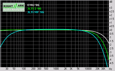

First of all, the output voltage is around -3dB below reference (no doubt due to the op amp analogue stage being bypassed), resulting in a slightly higher noise floor and correspondingly lower dynamic range, plus higher THD+N, IMD+N and stereo crosstalk.The following graphs are all based on measurement of the player playing back test tones at 96kHz 24-bit. In these graphs, the cyan plot is the modded Front Left/Right output, the green plot is the unmodded 2ch output, and the white plot is the E-MU 1212M measuring itself in loopback mode.The modded Front Left/Right outputs seem to attenuate both high and low frequencies more aggressively than the unmodded 2ch output, with the frequency response down -1dB at 30 Hz, and also -1.5dB at 20kHz:
By contrast, the unmodded 2ch output is flat to 20Hz, and only down -0.75dB at 20kHz.In a conversation with Joe on these results, Joe indicated that the slightly more aggressive high frequency attenuation for the modded output was intentional, and deliberately tuned by ear for euphonic playback. Joe suggested the attenuation at low frequencies was due to the E-MU 1212M having an input impedance of 10 kohms, and would be a lot less for a normal pre-amp input at 100 kohms. If this is correct, it would suggest that the player needs to be matched with an appropriate pre-amp, and is not recommended for use with passive pre-amps.Looking at the noise level, the JLTi has a noise floor at least 10-20dB above the E-MU 1212M capture card. The most significant contributor to noise is residual 50Hz (fundamental plus harmonics) from the power supply. In addition, there are significant spikes at around 5kHz, plus several out of band spikes clustered around 30kHz.

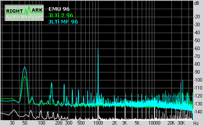

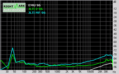

This is the graph comparing the outputs in response to a 1kHz tone at -60dB:

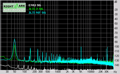

And this graph shows THD+N (at -3dB FS):

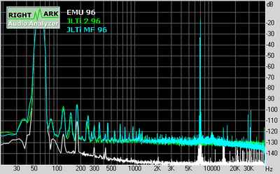

Intermodulation

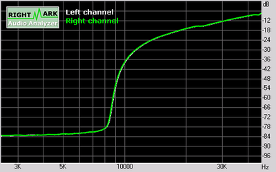

As can be seen, stereo crosstalk is uniformly good across the whole frequency spectrum:

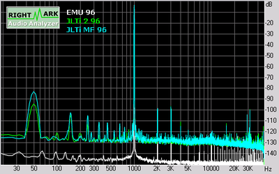

Unfortunately, the modded 5.1 Front Left/Right analogue outputs seem to exhibit a problem with the intermodulation distortionsweep above 1kHz:
In contrast, the intermodulation distortion for the unmodded 2ch output appears normal:

Playing a selection of vocal CDs, it was soon apparent that this “harshness” and “darkness” is part of the sonic signature of this player, as I can also hear it on the SACD (2ch) of Jane Monheit’s voice in Too Young To Go Steady from Terence Blanchard’s Let’s Get Lost (Sony Classical SS 89607). Finally, Alison Krauss’s voice (already oversibilant on the SCD-XA777ES) just sounded painful on Forget About It (Rounder SACD 11661-0465-6).
The third “fault” I found related to PRaT (pace, rhythm and timing). For some reason, music just didn’t flow very naturally on this player, sounding somewhat hesitant and stilted, almost as if all the musicians on each disc decided to play in a rubato fashion.
After I complained to Joe that the player sounded a bit harsh and uncertain, he suggested that I swap it with a production model.
What a difference! The production model sounds completely different, although I noticed immediately that it did not sound as “loud” as my other players. Subsequent testing on Audio RightMark revealed that the player’s “modded” output (on the Front Left/Right channels of the 5.1 analogue audio outputs) is down approximately -3dB below the 2Vrms reference.
However, once I compensated for the difference in volume levels, I noticed the harshness/darkness had disappeared. Likewise, the music seemed a lot smoother and more “liquid”. I played my favorite reference track for audio comparisons, The Girl From Ipanema from Getz/Gilberto (Verve SA-CD 314 589 595-2). João’s voice and guitar came across beautifully, and the bass sounded nicely solid, and the piano sounded exactly like it was right in front of my living room. Astrud’s voice sounded full of air and presence, and cymbals sounded nice and clean.
In comparing the new player on SA-CDs against the Sony SCD-XA777ES, I found it difficult to distinguish between the two. Both of them sounded rich, warm and luscious. Given that the JLTi player retails for less than half of the RRP of the SCD-XA777ES, this is an impressive achievement indeed (although to be fair, the SCD-XA777ES is a full 5.1 capable player unlike the JLTi which is optimized only for 2ch).
Listening to Joni Mitchell’s Both Sides Now (reprise 9362 47620-9) again, it now seemed as if the Panasonic DVD-S97 was the slightly harsher player in comparison to the JLTi. However, and perhaps I’m imagining it, I felt I noticed the less than flat frequency response of the JLTi in comparison to my other players. Low notes didn’t quite have the same “thump”, and the high end sounded just a tad smoother and less detailed. The effect was very minor, and consistent with the measured frequency response, which was down -1dB at 30Hz or -1.5dB at 20kHz.
On CDs, the JLTi player sounded slightly more “airy” with more “tizz” around the high frequencies compared to the SCD-XA777ES. Given the player’s measured results, I wondered if what I was hearing was a result of intermodulation distortion.
As a result of my measurements and subjective impressions, Joe told me he had tweaked the filter cutoff frequencies to reduce the bass roll off and hopefully lessen the intermodulation artifacts. Hopefully, this should make future models of this player sound even better.
