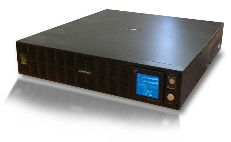

PR1500LCD Build Quality and Outlets
Cyberpower UPSWhen you invest in electronics, be it for the home theater or for the home office, battery backup is something that should not be left out of your budget. In these days, when time equals money, it's unthinkable that a lightning strike, random brownout or other electrical snafu could cost you hours of work or even thousands of dollars in equipment. While many people connect some sort of surge protection to their systems, nothing less than a UPS (Uninterruptible Power Supply) will guarantee your work doesn't get wiped out when someone down at the local power station decides to trip over an extension cord, or a squirrel forgets that running the Nutty 500 race across a wet power line might not be the best decision he's made all week.
Florida, where this reviewer lives, is considered the lightning capital of the U.S. Florida Power & Light stated that there were more than 330,000 lightning strikes in its service territory (which covers about half the state) during 2002. Of course, according to the department of energy, there are over 100 lightning strikes per second across the face of the earth, or 8.5 million per day. Battery backup is starting to look pretty good to me these days. It was with this mindset that I opened up the CyberPower PR1500LCD to take a look at what it could do. The full product model number for this device is PR1500LCDRTXL2U, but I find that almost repulsively too long and will hereby refer to it as the PR1500LCD to keep it simple.
Features & Build Quality
The PR1500LCD series comes in two "flavors". The RTXL2U is the model being reviewed and the RT2U is rated at slightly less power and without the ability to add the expansion battery for extended runtime. This is only the second UPS system we've ever seen with the ability to expand runtime with an external battery pack - a feature we can really appreciate and one we use in a competing brand powering our home theaters. Both models can be used in either a vertical (tower) or horizontal (2U rackmount) configuration. Hardware is included for rack mounting the UPS to a standard equipment rack.
The PR1500LCDRTXL2U is geared towards protecting mission-critical servers, telecom equipment, VOIP and networking hardware. This is a serious device and it outputs both a Pure Sinewave waveform as well as providing full Automatic Voltage Regulation (AVR). For smaller surges and undervoltage situations, the AVR is instantaneous. When the input voltage drops below or rises above the set UPS limits, the PR1500LCD flips the loaded equipment over to clean AC from the battery in less than 4ms. That's quick enough to handle any spike, brownout, or blackout scenario without resetting your system. The UPS not only boosts voltage during low (under) voltage scenarios, it also cuts voltage during spikes or periods of excessive voltage - all without switching to battery mode. This conserves battery life (a big plus) and allows the PR1500LCD to deliver a very stable signal to your connected equipment.

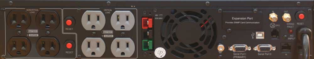

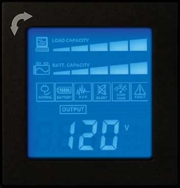

LCD screenThere is a multifunction LCD display that we found extremely useful. It provides constant monitoring of the power and battery condition including Run Time, Load, Temperature, Fault condition, and even whether the unit is operating in silent mode (with the internal speaker off). The PR1500LCDRTXL2U includes three rear ports (which CyberPower refers to as a battery expansion interface) that will handle the addition of a battery pack that increases run time in the event of a power failure.

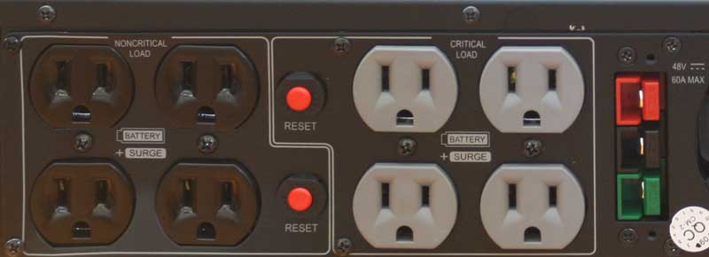

The PR1500LCD features eight battery and surge protected receptacles (NEMA 5-15R). Of these, four are designed to serve as "fail-safe" options for protecting critical loads. What's cool about this is that the system will actually shut down the other 4 receptacles first in the event of a power interruption, leaving you a precious few minutes on more critical equipment to get it powered down in a worst-case scenario. The UPS has four maintenance-free, user-replaceable 12V/9Ah batteries. Typically, batteries last around 4-5 years, and CyberPower provides a limited warranty for 3 years.

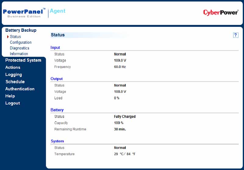

The included PowerPanel Business Edition software not only monitors the UPS status, but can be configured to shut down up to two servers* connected via RS-232 - even without user intervention. In this way you can make sure that your servers shut down properly at a certain point of power depletion, rather than allowing the system to exceed its limits and cause a hard shut-off.
PowerPanel software
*requires that PowerPanel Business Edition be installed on the second server as well.
The software shows the same information as the LCD panel, but in the case of remote use, you can monitor that information without having to go into the equipment room and check the rack. You can also set the thresholds at which point the system will provide voltage regulation and engage the battery system. The software is compatible with all modern flavors of Windows. Linux users can download the PowerPanel Linux software and is not natively Mac compatible at this time. If you are using a Mac, just use the Apple-provided Energy Saver UPS manager which will allow you to configure a number of options for the PR1500LCD.
