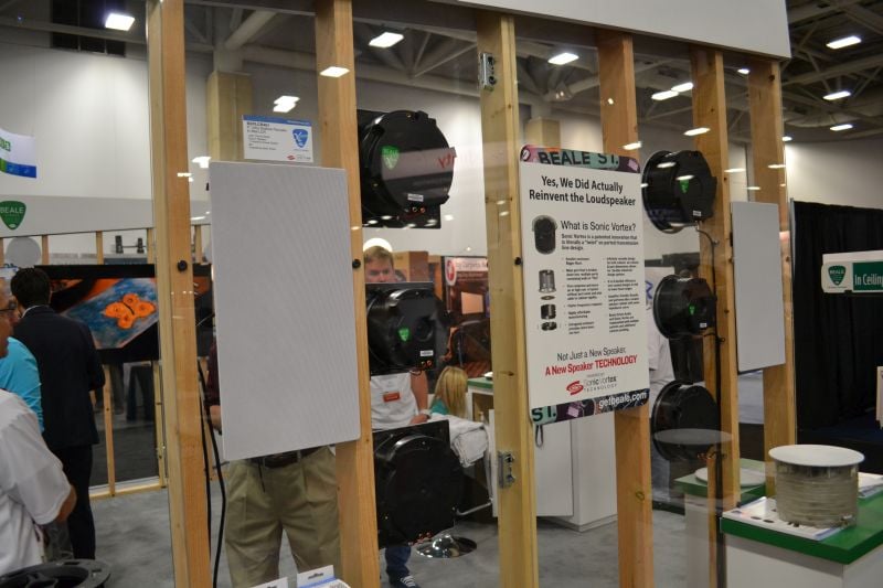

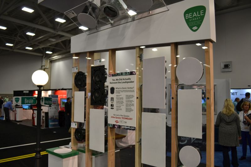

Beale Street Audio at CEDIA 2015

Beale’s twist on speaker design, and it is a real twist, involves and old and well-known technology, an acoustic transmission line. At the risk of oversimplifying the idea, you can think of a transmission line like a really long port on a speaker. Most commonly, transmission line speakers force the sound created on the back side of a driver through a long duct and then out of the speaker enclosure. By adjusting the length and size of the duct, the designer can manipulate which frequencies are boosted from the transmission line and how much they boosted.

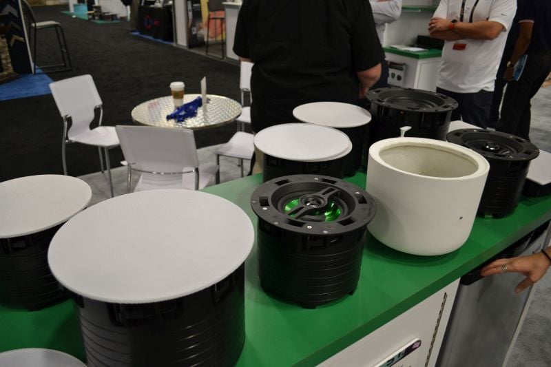

Biele Audio in-ceiling speakers
Beale Street Audio In-Ceiling Speakers
What Beale audio has done is integrate transmission line speakers into the enclosures for in-ceiling and in-wall speakers. The sound coming off the back of the speaker driver, or divers, is routed through six tubes that wrap around the outside of the speaker and create the speaker enclosure. The ports eventually fire out the front of the speaker. They call this Sonic Vortex technology, which pulls double duty by increasing bass output and preventing sound coming off the back of the speaker from traveling into other rooms.
At CEDIA, they were showing off brand new two-way in-ceiling/in-wall, full range “Pancake” speakers that measure only two and three quarter inches deep. These are ideal for the European market and in cities or other places where ceiling or wall depth can present installation challenges. Currently, two models in the Pancake series will be available with more planned for the future. The P4-BB is an in-ceiling/in-wall ultra-thin speaker that features a four inch two-way Carbon Fiber woofer and three-quarter inch Titanium tweeter. The IPLCR4-BB is a LCR speaker that features two four inch Carbon Fiber woofers and a three-quarter inch Titanium tweeter.
Beale Audio pancake speakers
Beale Audio PF-BB and IPLCR4-BB pancake speakers
Thanks to the Sonic Vortex technology, the enclosure is actually a compact, integrated, tuned cabinet that offers a ‘twist’ on Ported Transmission Line design to produce bigger sound than you might expect from a 2 ¾-inch deep speaker.
