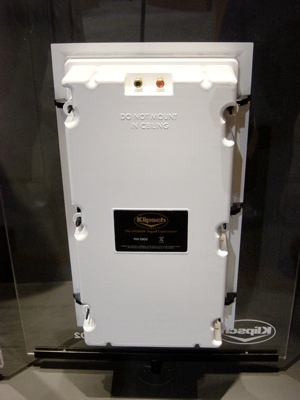

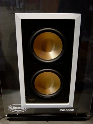

In response to installer demand for a powerful subwoofer system that delivers deep-driving bass without taking up valuable floor space, Klipsch has introduced its new RW-5802 in-wall subwoofer with matching rack mountable amplifier.
Fitting standard 2- by 4-inch construction, the easy-to-install RW-5802 in-wall subwoofer can accommodate any new or existing structure with a minimum 0.5-inch dry wall surface. Because it features an MDF baffle with a reinforced composite sealed enclosure, this high-powered, passive module subwoofer provides guaranteed performance and minimizes sound transfer into adjacent rooms.
The enclosure houses dual 8-inch long-throw woofers. These exclusive drivers feature stiff, well-damped Cerametallic cones, a specially treated aluminum that has been anodized, or electrochemically transformed into ceramic on both outer surfaces. Second only to diamond in strength, this ceramic compound allows the woofers to move at high speeds without blurring the sound like conventional designs.
